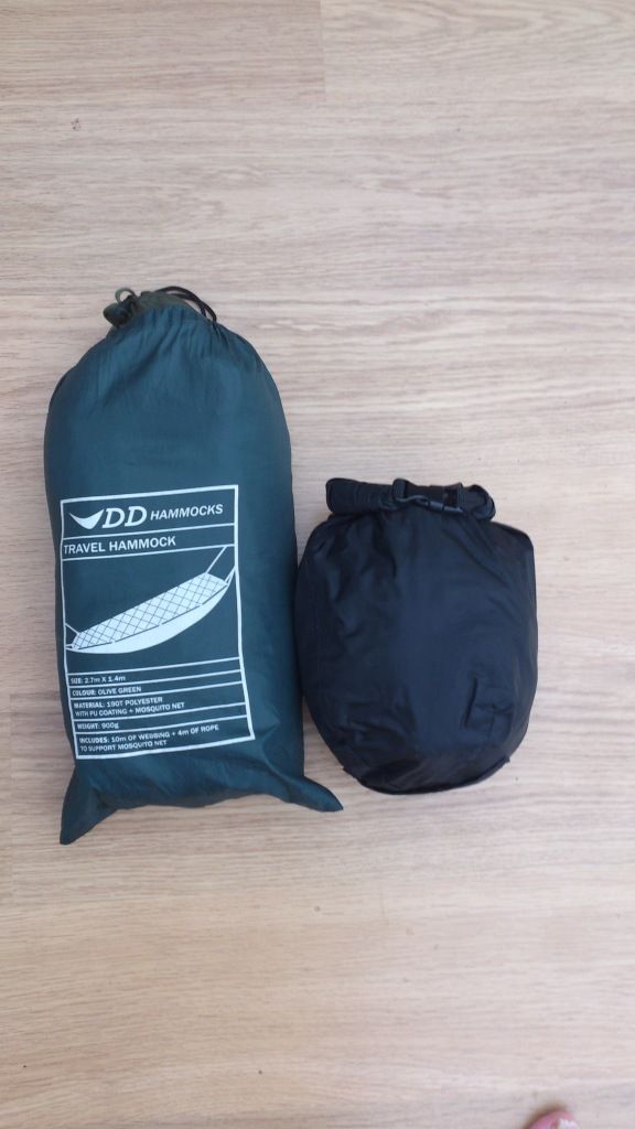

I have snakeskins on one of my hammocks but find it takes more space up when packed than it does is i just stuff it in a drybag and expell all the air.
Both are DD Travel hammocks,
Left has snakeskins right doesnt but includes tree straps and whoopies and soft shackles.
