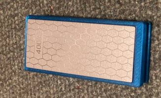

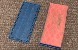

This is very timely @Dave Budd , thank you. Last year I was given a set of diamond sheets of various grades. I’ve only used two but I will bear your advice in mind with the unused sheets when I eventually use them.
My son printed a wonderful box for them. It has two lids. The top lid closes the box but has a recess and end stop for a single sheet so it’s like a conventional stone.
The other lid is on the bottom and covers a strop.
