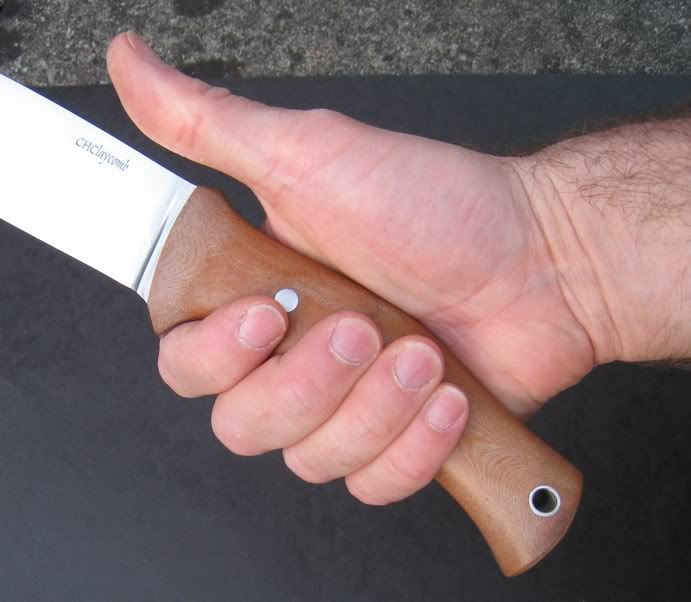

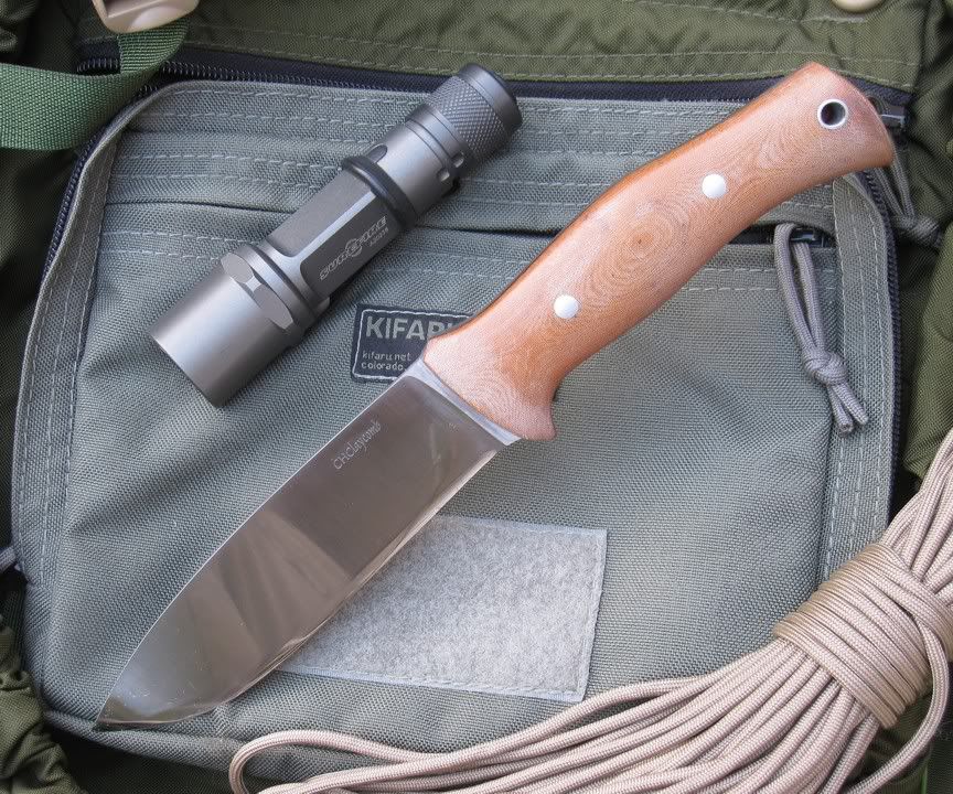

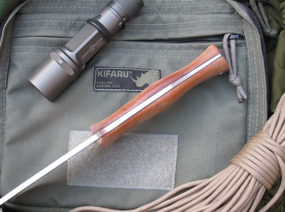

Just finished this. Its been a long time in the making and the would-be recipient has been waiting a very long time for me to make him something. Thanks for being patient!:You_Rock_
6 inch blade and a handle just over 5 inches. Flat ground with a convex edge from 3/16th O-1 stock. Tapered tang, Tufnol and black liners all held together with stainless bolts and shafting epoxy.

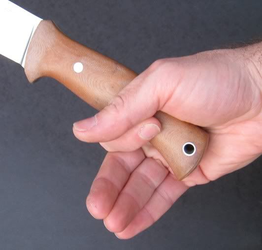

The handle appears long, but it has been made that way and is intended to work with hands my size, not just great mitts.
The length alows you to take a grip right at the back to increase the ability to chop and swing cut.

The knife is an anthropometric dream, all the positions are great to hold and the 'chopping' hold feels particularly secure considering it is a half hand grip. To my great shame I thought about selling this knife before it arrived as money got a little tight. I don't think you will pry this from my cold dead fingers.
