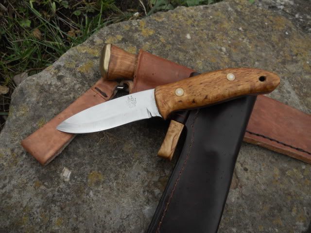

And at least Mine are HandMade
Not Factory Made
Well my hand made Spydie is brill. And yes mine is handmade
SF, Maybe it's the camera angle but I'm not convinced on the shape of the end of the handle on the one
And it looks like the second pin is off centre so I guess it must be camera angle
Mark
dont think its ever been claimed as a hand made knife tho i think its hand finished on the handle due to the complex shape ( i assume copy CNC routed to close then final finish and polish by hand )
handmade dosn't nessiceraly mean good and how far do you go do many makers make their own mosaic pins or loveless/corby bolts or buy in pre cut scales or pre made Micarta does tru hand made mean no power tools at all is GFS pre finished to thickness so mostly machine finished already etc
ATB
Duncan
Very true I guess, I've seen some very poor hand made knives on here:yikes:
The quality of the end product is the important thing
Mark

Fantastic, wish i could put stuff like that.
