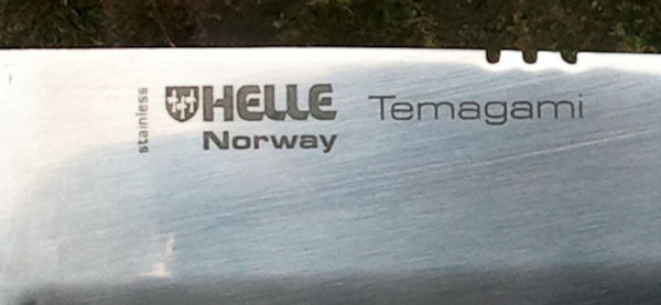

Great knife indeed. However, how do I tell if I've got the stainless steel or carbon steel version?
In anticipation,
Grasshopper
For future reference, and in case this ever crops up again, an easy way to tell:
Note the word "stainless" in small letters etched to the left of the main Helle logo - dead giveaway :)
I only found out myself this morning when my stainless Temagami arrived :D
