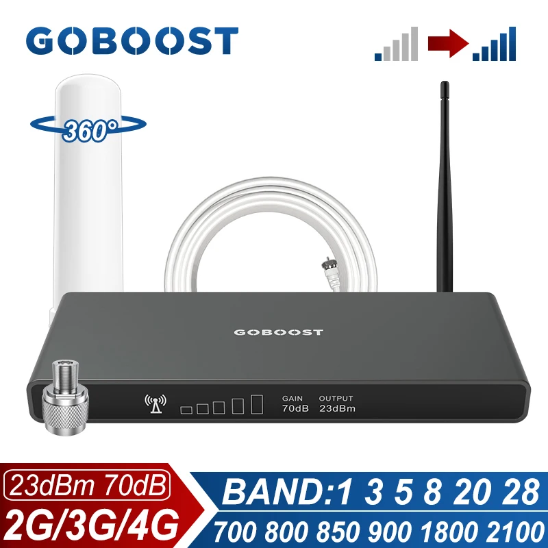

We lived in the van for a few months and used a 4G signal booster. You need a little bit of 4G obviously, it wont create it, but the boost even one bar on the phone gave the iPad via hotspot was brilliant. Ours was just in the front window facing down the valley where there was always a bit of 4G, but pole mounting the small aerial would probably have made it 100% consistent. I very nearly bought another one for the house now we’ve moved, but found we have a cable connection offering high speeds and got a good deal from EE who I’ve been with for years.
GoBoost store on AliExpress were really helpful via WhatsApp, even after sales, making sure we had the correct kit etc for our needs and helping us getting it all connected. Not many sellers would take the time to contact asking if we had a 12v lighter socket to run off and then including the plug. Much easier than plumbing it into the electrics or running another cable.

GoBoost store on Aliexpress. The one I had was 12v car use, no good to your mum.
Also, you need to know the frequency of your mobile provider signal. They will help you with this, it’s a button press on the phone, a bit like how you find your IMEI number by button combo. O2 and EE are Freq 20, which is 800. They recommended this for home use for the 800 band.
£59.98 40% Off | GOBOOST 70dB Signal Booster 2G 3G 4G Cellular Amplifier LTE 700 800 850 900 1800 2100 MHz Network Repeater With 360° Antenna Kit
Also may be illegal in the Uk, they are essentially rebroadcasting the signal and as such may require licensing unless on the approved list of equipment. My former employer had one installed at his house and was paid a visit by OFCOM because it was interfering with the masts in the area. OFCOM link
Technically they’re not legal, because OFCOM want you to buy the ones they recommend. There’s a bit of a monopoly thing going on I think.
