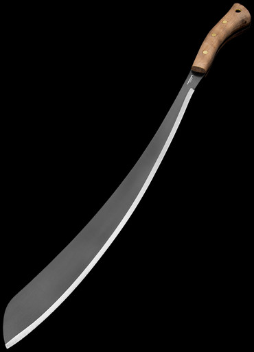

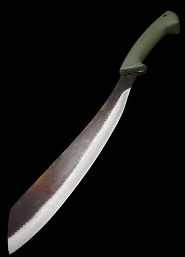

Glad to hear Condor may have improved things over the years with their parangs. I have an old Condor Parang (don't think it has any other parts to the name) and it is terrible - it's really thick, it's really heavy, and the edge bevel is really steep so it acts more like a (rubbish) axe. The weight and lack of balance means it's tiring to use and only gets brought out when I can't find one of the decent machetes. Not sure why I didn't return it when it arrived all those years ago!
Sounds like the first Condir Parang I saw.
Like this one??
Mary,
This?
Or this?
Like this one??
That's looks like the one - horrid thing in my experience though I did see previously that they've made a few versions of it, calling it the same thing, sometimes with a partial tang so it's possible they make other changes to thickness and grind over the years without renaming them. That price you've linked to is I think over double what I paid.
