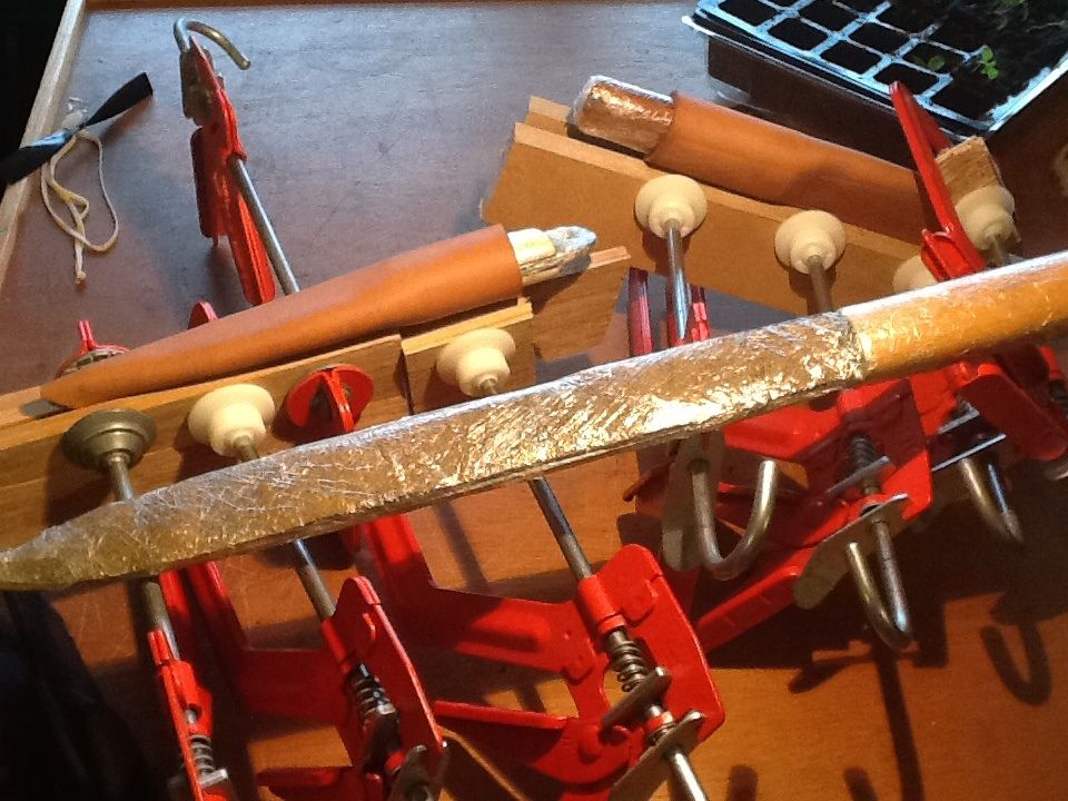

Today I cut out blanks for the Roman and Saxon knives, soaked them in cold water for a few minutes, worked the Roman one into shape so the seam is at the back and the Saxon one so that the unwelted seam was along the cutting edge and clamped them up as best I could.
I've wrapped them in lots of cling film so hopefully the blades won't rust enough to pit. I'm not sure how long to leave them to dry.
For the 14 inch seax I've cut out 2 handed pieces of shawn sheepskin and cling filmed them into place so when I wet form around that one later this week.
