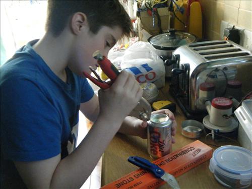

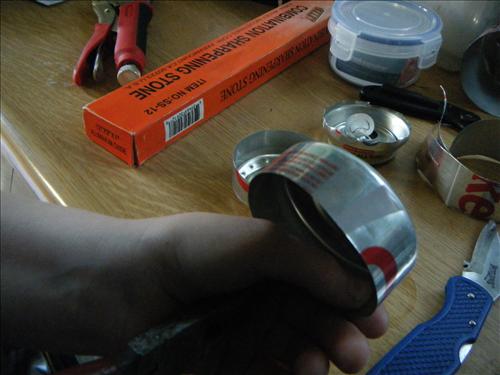

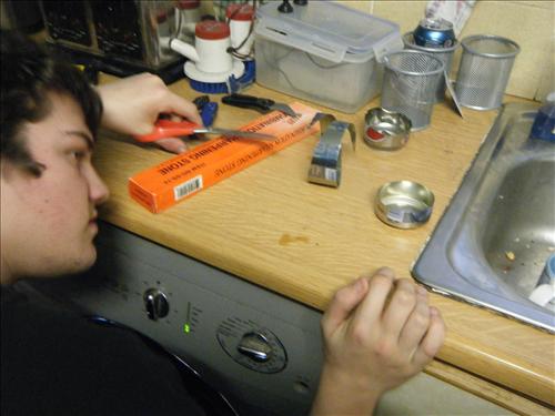

Laying the knife on the sharpening stone in its box, left the tip of the blade at just the right height to scrape a line round this can by twisting the can...

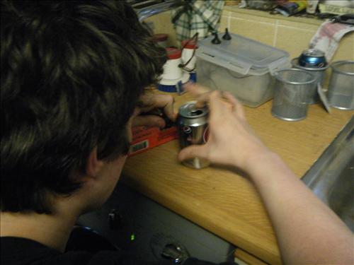

He is roughly hacking the top of the can off with his penknife - hasnt cut himself yet.....
Cutting down the side of the can to the line he scraped with a pair of household scissors...
New shiney !

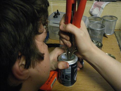

I got these just for this job!

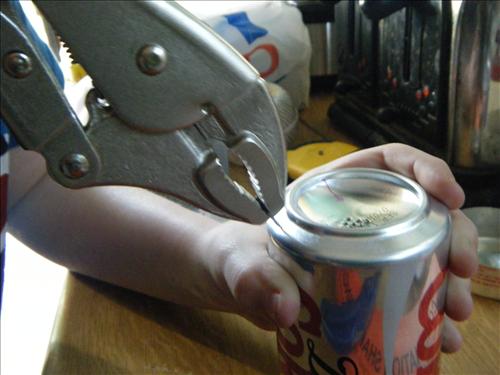

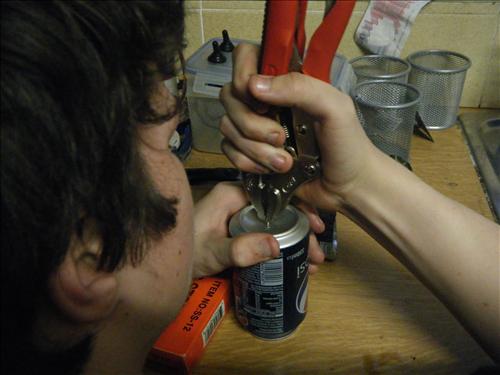

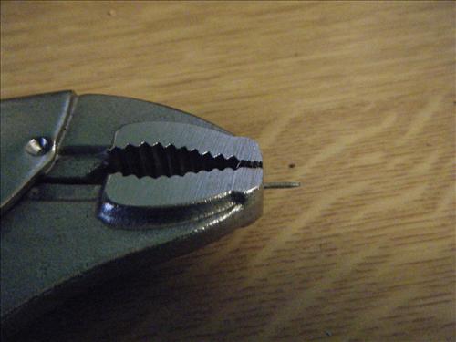

I also found a plastic topped thumb tack and crunched the end off it and put the pointy bit in the jaws....
Could have given this job to my biggest, but...I wanted to get it done.
He says its top is flat...
He is pushing the pin through the bottom of the can.
He made 7 holes....er....8 holes. Seems he lost count.
Hes now putting a ring of holes around the edge...
They are nice and er... randomly spaced.
I guess that will still work.

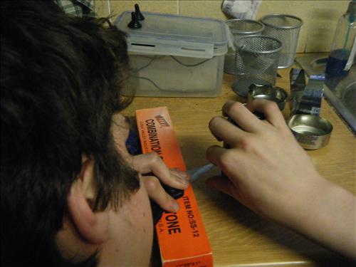

He is scraping a line on the tin he just made holes in...
Astinishingly, he is still not bleeding.
That knife must be blunter than I thought.

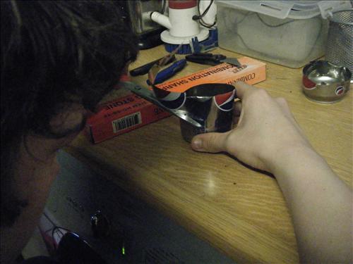

Scissoring it down to the line...

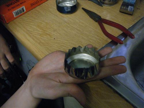

Sort of crumpling the edge with long nosed pliers.
He is being careful not to fold it so far down that its shoulder gets creased.
He managed to push them together slightly skewed.
Took me a while to level them out again.

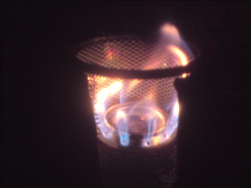

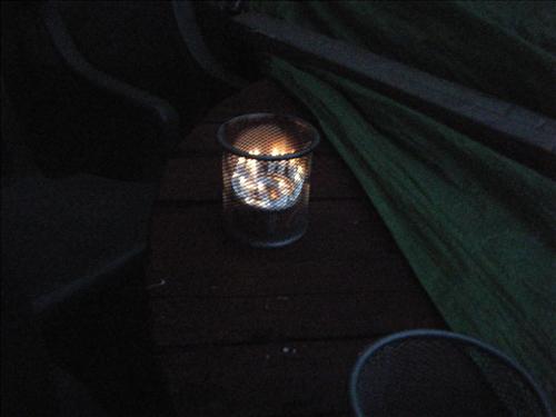

Took it outside and tipped some Methylated spirit in it.

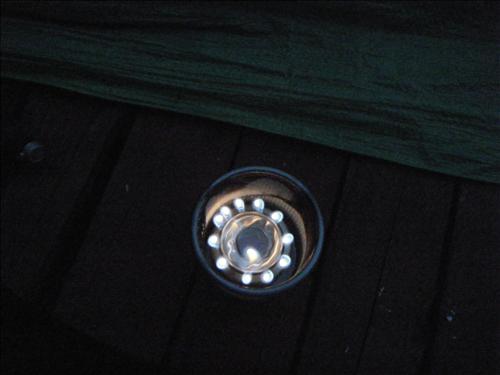

Put a 2p coin on top of the holes in the middle.
Tipped in a little more meths and lit it with a blowlamp.

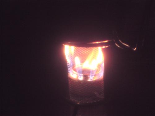

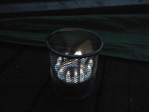

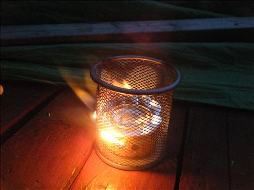

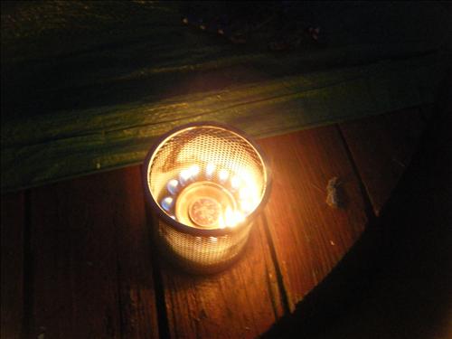

It took it a while for the top to get hot enough that it started popping and the holes round the edge lit..

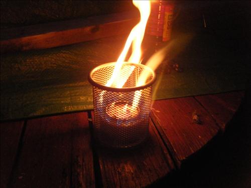

Er.....Looks like the paint on that pencil holder is flamable.
Its burning really nicely with no smoke.
I like it!

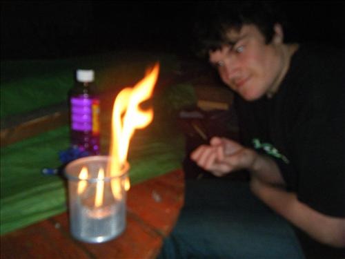

Its on fire again!
Once the paint is gone, it will stop flaring.

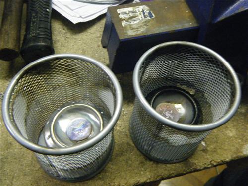

I also tried shortening one of those pencil holders so it would fit in a plastic pot I found.
Er....
Not one of my better Ideas lol.
It was so close to the stove, it put the flame out.
Glad I didnt destroy all three!

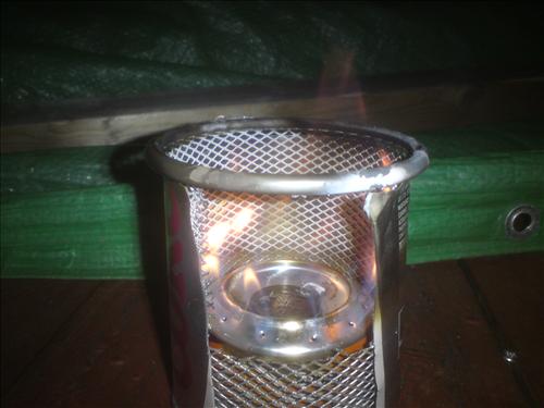

I poked a hole in another of the pencil holders and wrapped it in another coke can skin, and lit it...
Im struggling trying to light it.

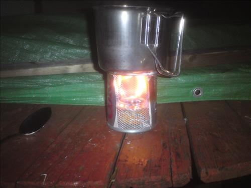

I think the penny stops the last of the meths going down into the stove, so it will burn on the top and warm the metal enough it starts the liquid meths vapourising so it will light through the holes in the sides.
It isnt getting hot enough.
Having to warm it some more with a blowlamp.
Dont know why. Anyone got any Ideas?

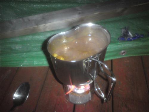

This is the first time Ive tried warming soup on any of my stoves..
I think the flames are a bit big too - possibly the jets are too big?
It really pushes out some heat when its going though.
The soup is done, and its still running.
I do like this stove. It doesnt smoke. You can also simply blow it out.

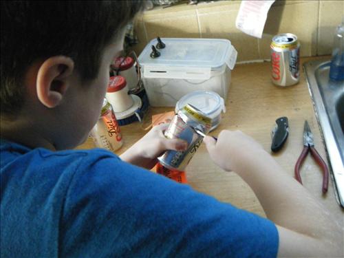

Little Idea finally noticed that Big Idea and I had both made a coke can stove each.
He was quite upset that I wouldnt let him take a day off school so he could catch up.
So....as soon as he got home....

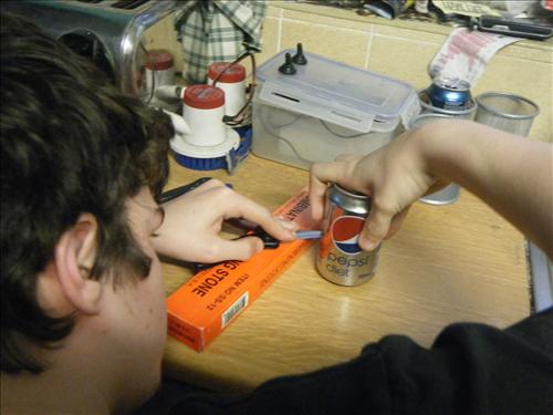

Time to mark out one end....
Hacking off the top with is super extra burred knife...
I did offer to test if it was sharp enough on his finger first...
More holes...
Shortening this end...
Cutting along the line he marked with his knife makes a nice clean straight cut.
