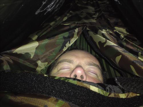

This new top does up right to my nose.
I like this thing.
The top is fixed on on both sides with velcro.
Lying here, I think that was a mistake.
I only need velcro on one side.

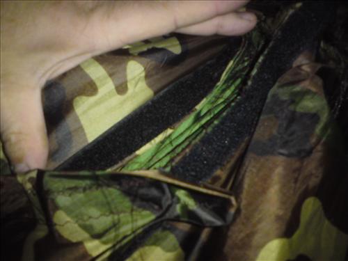

This is the velcro join.

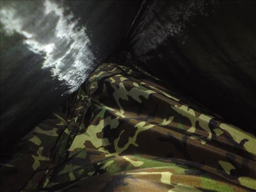

When its stuck together straight, its draft proof. It does leak if you get it wrong.
The ends need sorting out as I have a gap at the end and its funneling cold air down onto my toes.

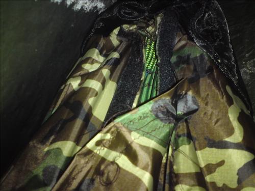

This shows the length that came apart.
I need a piece over the end, with the top under it.
Ive not quite fgot it the right shape.

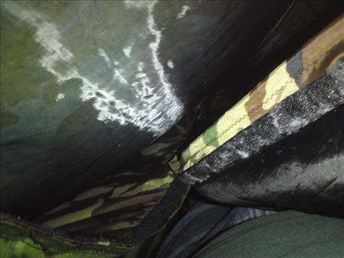

My feet got cold and there was a cold line along the velcro seam on one side.
Need to get some insulation behind the velcro.

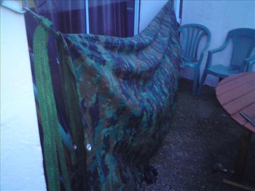

THe wind kept thrashing the tarp against me.
The noise was something else.
Need some weights tied to the corners to keep it under control.

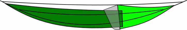

My guess is that to make it work, you would need to have the cover over your hammock separate to the cover over your face.
Ive cocooned my body in insulation ot keep it warm, with an openable side in case I get too hot - which would make me leak more water into my bedding, and then made a channel above it with netting to give my breath somewhere to dissipate without soaking everything.
I think that pull up sock thing will only work if you split it with one side covering from your feet to your neck and the other side over your head and enough over your chest to stop the water getting in - maybe with a little netting to stop wind and rain.
When listening to what I am saying, please remember that Im not an expert on this stuff.
Hang on I will do a scribble....
The dark green would be the sock from one end, and the light green would be the sock from the other end, with the netting to keep the rain out in the middle.
It would probably need an extra line to keep the light green sock off your face.
