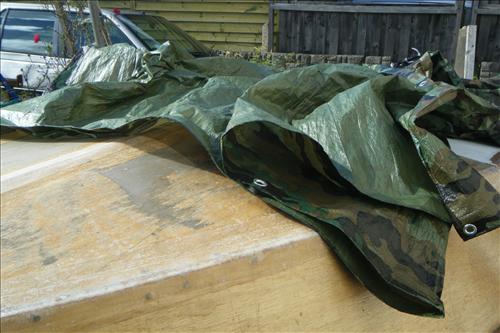

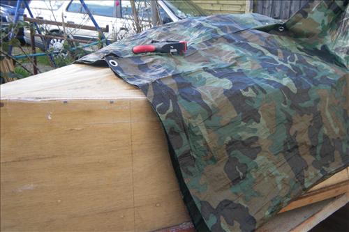

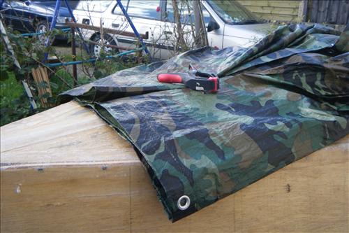

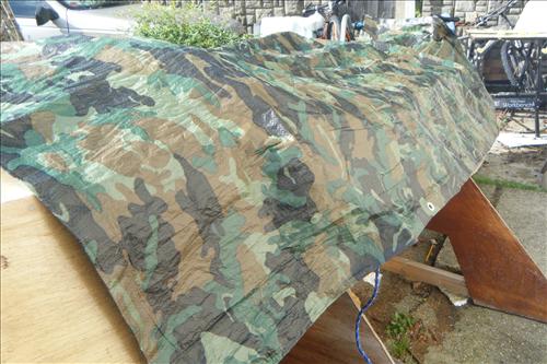

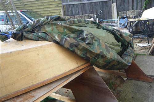

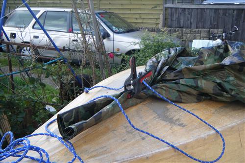

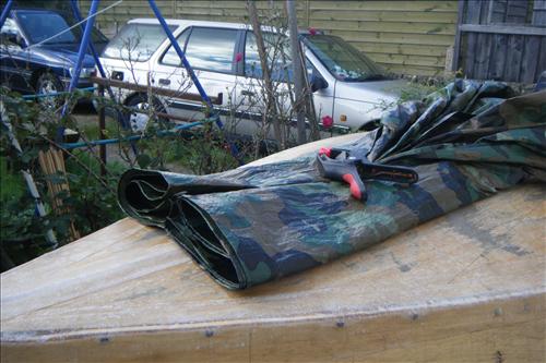

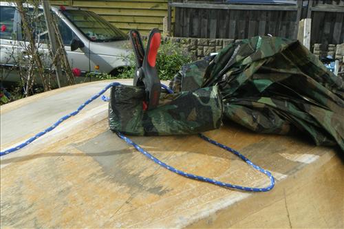

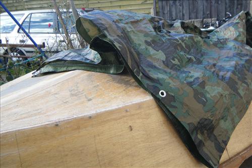

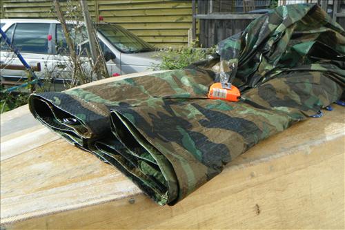

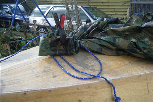

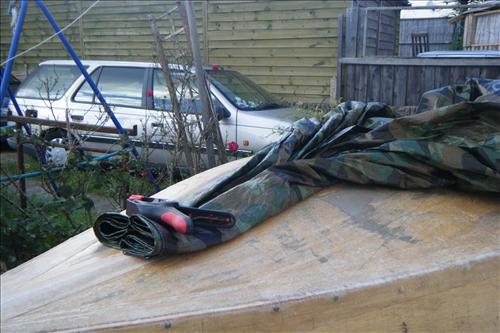

A kids poly tarpaulin. Its 3.3 x 4m. It’s a bit too big, but that’s what I had on the floor in the kitchen.
Ive spread it out on top of a couple of boats as I havent much space.
Ive found the middle and folded both corners at this end to it.
Ive folded both in again and put a tape measure on it to stop it undoing.

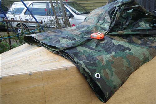

Both sides folded to the middle again
..and again
Ive folded the two sides together and stuck a clamp on so it will stay there while I take this pic.

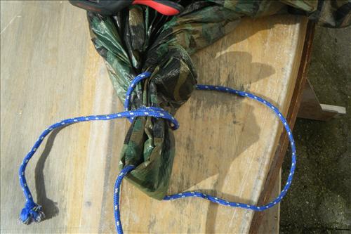

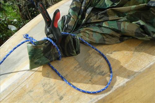

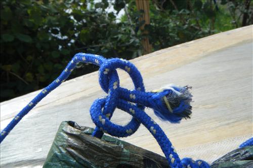

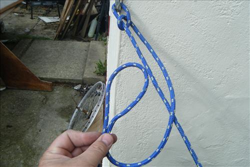

Ive laid the end of the rope over it. This is nasty thin 6mm stuff that I dont really trust, but hey ho.....
Ive flicked the end over to the other side to make a loop - must not lose the loop.
Ive folded the end over the rope loop
Ive takend the end under the folded hammock and up through the loop
Ive flicked it back over the top
Ive taken it around the long end and through...
Ive put another loop in to complete a slide knot.
Pulling it tight pulls in the first loop too.

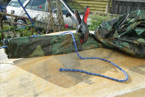

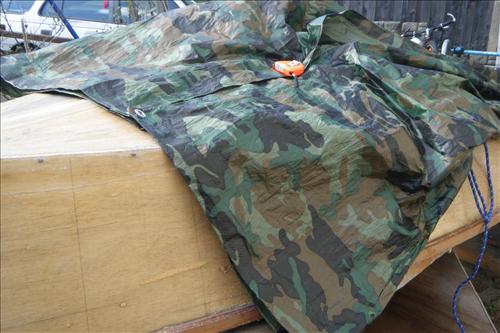

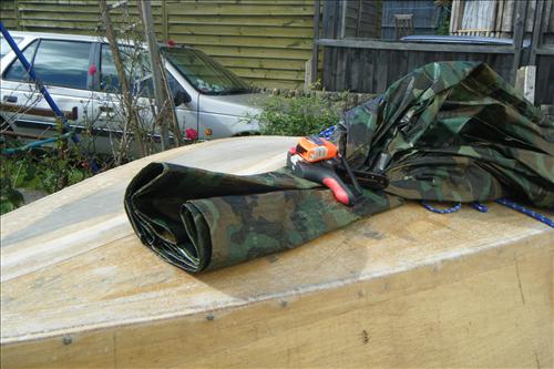

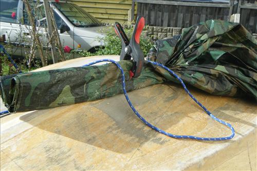

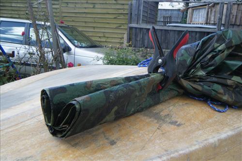

Folded it in half to find the middle - its on the right..

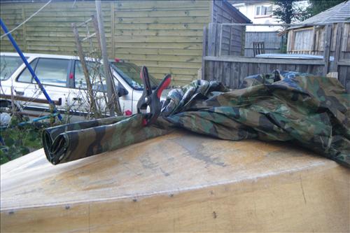

Folding the ends to the middle - clamp just keeping it still for the pic
Folding the sides in again
...and again
...and again. Looking to get it small enough to tie it. Actual no of folds is irrelevant.
Folding both sides together

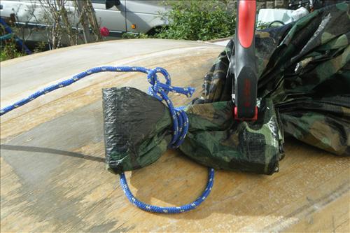

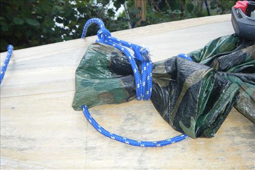

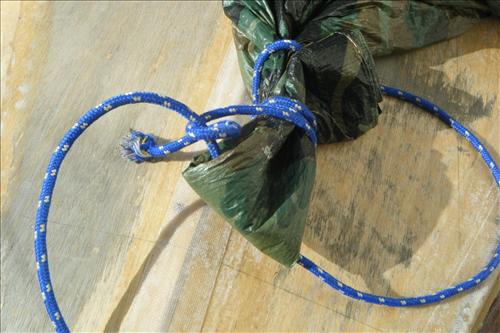

Rope loop over it

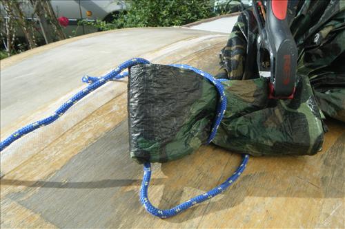

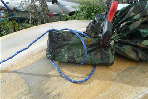

End of tarp folded over

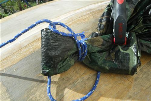

Winding the end round to keep the tarp from opening out
First pass round
Secong and third pass round - fold is too big to fit through the rope now.

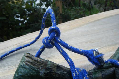

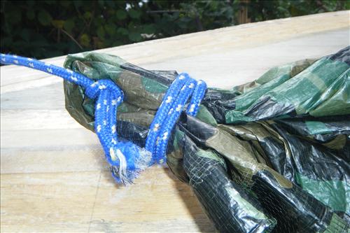

First loop round the main end.
Second loop making the slip knot
Made me smile.
So what was Mr Deer?
Edit. Oh and Hello everyone I've just realised I have only lurked on here not contributing.

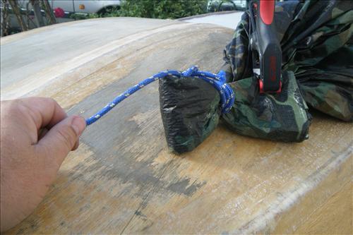

Pulling the long end tightens the whole thing up
The hanging loop of rope pulls round the ring of rope going the other way and then buries itself in the tarp fold
Thats it done.

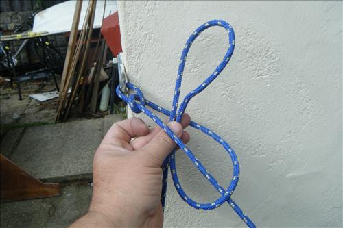

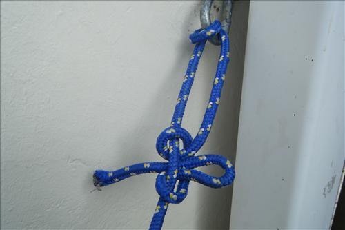

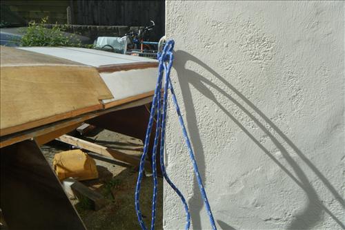

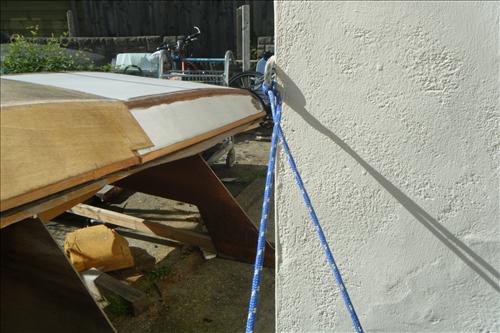

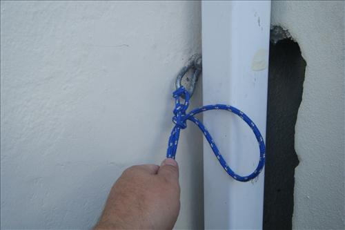

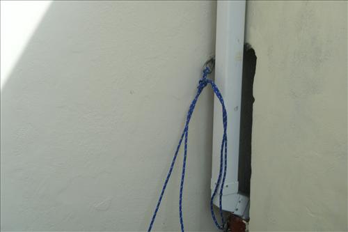

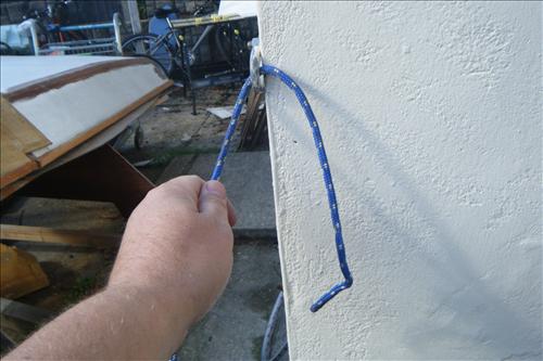

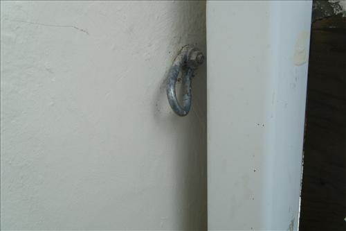

No trees in my garden, so Im using these

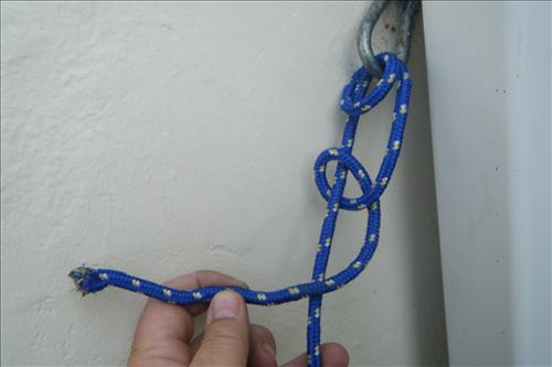

end of the rope round it
second loop - grips better on real trees

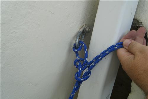

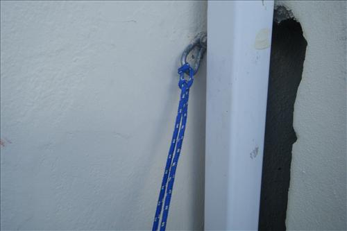

under it over it and through the loop
take the end back over it
make a loop
under the main rope and through
I like it a bit bigger than that.....
so again....
first loop over it, under it and through
pull the loop to tighten
One end done

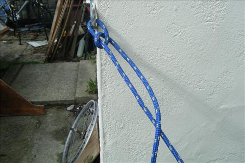

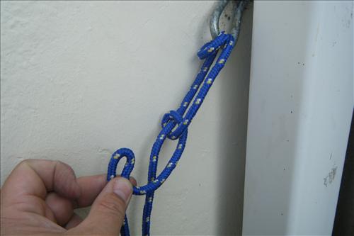

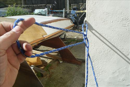

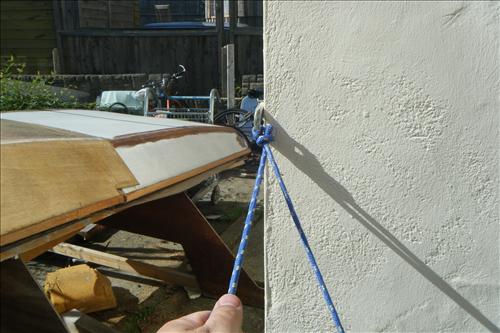

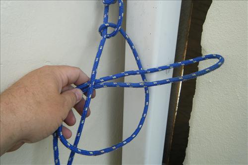

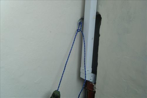

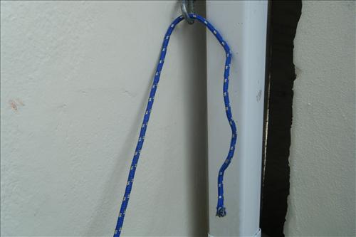

pull the other end round another tree - except I havent any

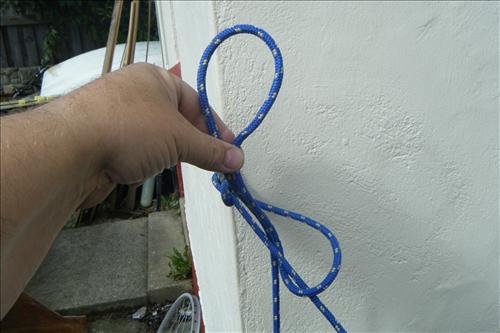

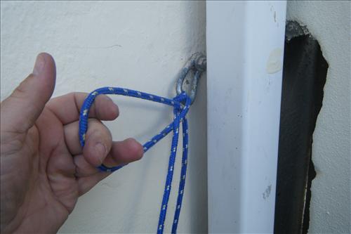

under it over it through.....
end over the top
make a loop
push it through
grab it from above - and I changed hands as I had the camera
pull it tight
done.

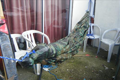

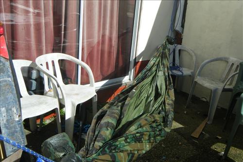

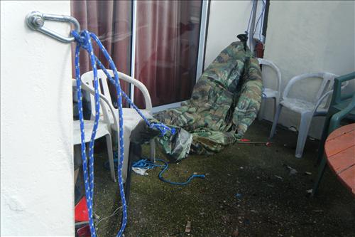

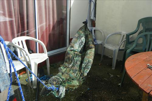

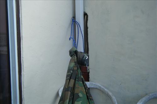

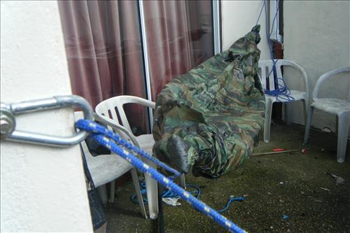

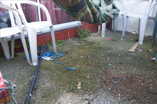

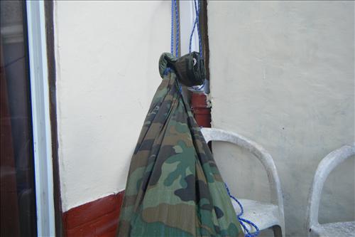

Its up - upside down.
Not that it makes any difference

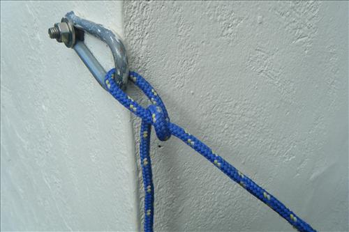

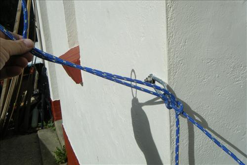

Straddle it and sit on it to stretch the ropes and tighten the knots.
It will sink a bit.
Redo the knots to get it back to the height you want
The knots on the ends of the tarp will usually sort of look like they are inside out.
Straddle it again until you can lift your feet and bounce without it moving - havent got any pics of me bouncing as my arms wernt long enough
Tighten it again....
That only takes seconds once you have the knack
Turn it up the right way
Have a really good look under it - just in case you roll out of it....
Check for arrows, tree stumps, stinging nettles - how come they hurt me and didnt stig of the dump?
I like haaaaaaammocks, best of all the sleeping kit….I like haaaaaammocks, they’re my friends….
Got this song in my head now.....Grrrrrrrr....bloody childrens advertising tunes :cussing:
Mojo

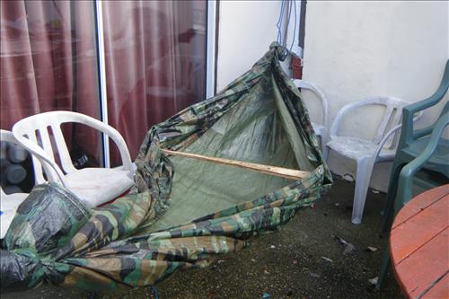

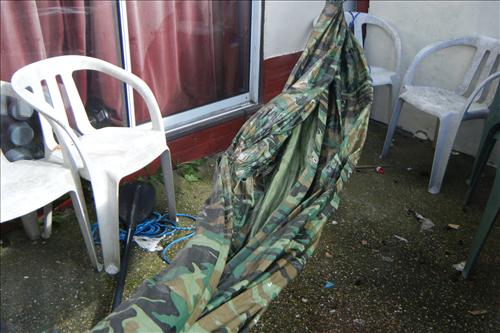

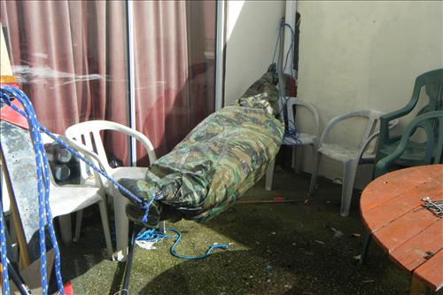

Open the hammock - arms not long enough again, so I used a stick.
Dont actually use a stick as it goes straight through it. Discovered that sleeping with my bow and arrows.
One last look at the knots - it has some slack in it, but thats sort of normal too.

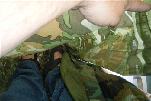

Sit in, then swivel and feet up.
I suppose I should take the shoes off first.
Too late.
There is enough tarp to pull it right around your feet so there is no drafts.
If you shuffle your rear over to one side - making sure you dont actually fall out...
...you can pull the other side right over you so you dont get wet even without a cover.
It leaks very slightly where the knot is creased on the top,but its minimal.
I weigh 21 stone.
It survived.

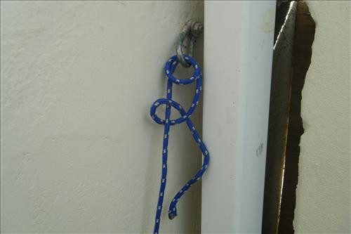

Time to take it down

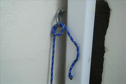

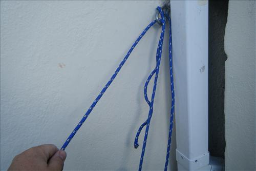

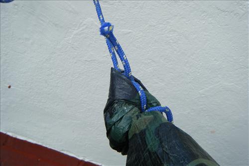

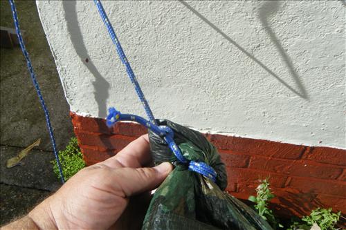

This is what the knots at the ends look like aft its been loaded (overloaded)
The tree end
Pull the end
The loop pulls out
Unpick the last loop
Unwrap it from the tree
Other end
Pull the end
Unpick the last loop - which isnt usually very tight
unwrap it from the tree

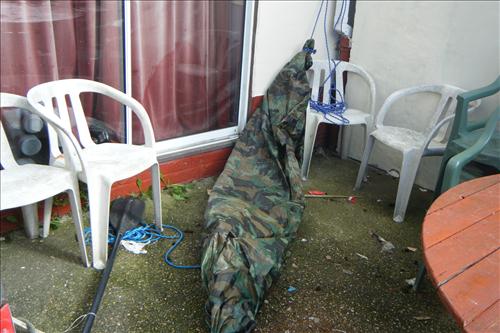

Its down

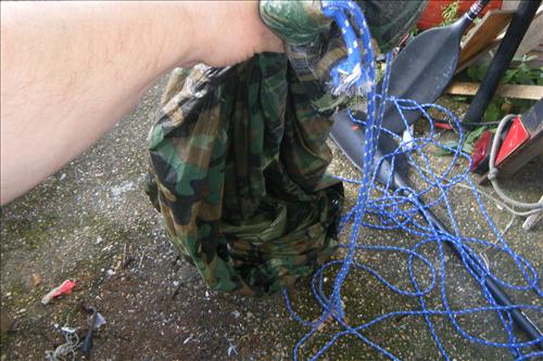

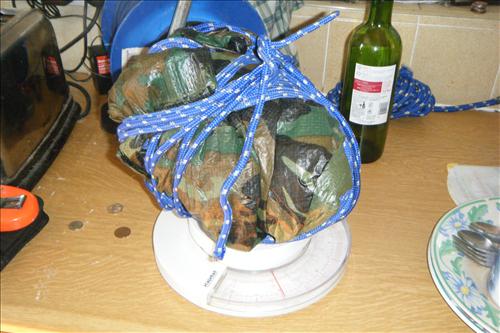

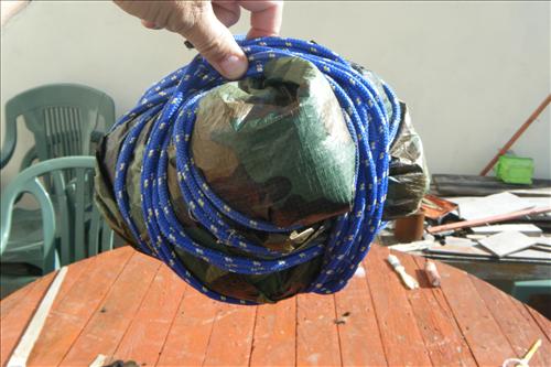

Wrapped up in a ball.
Normally I just pull them to bits again

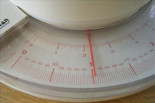

Thought I would weigh it as I had it whole
Out of time again.
