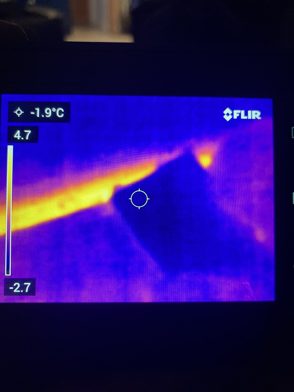

Do you have access to a thermal camera?
You may have a local library of things that has one.
This is part of my loft yesterday - helped me realise I need to get some insulation right in the very end between wall and joist!!
Cracks and gaps in the floorboards can be filled from below to save you trying to colour match and re polish.
