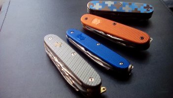

Folder with just a knife and saw?
Pretty sure you can't buy the bits, I think donor knives are needed. It's not very straightforward to take them apart either, the handle scales need heating to melt the glue, pins need tapping out, the back springs are fairly strong and hard to hold in position for fitting it all back together.
It's not difficult at all. Scales pop off easily, warming them just limits damage to the mounting holes so you can potentially re-use them. Pins need drilling carefully but can be re-used it you're removing a layer or two. Backsprings are not very stiff so easily go back together with a twist and hold their place while the next layer is added. The fiddliest part is peening the pins over smoothly and with the right amount of compression.

To my mind, considering the size of the range, I’d take the best compromise and not bother changing it. On BB and EDCForums there I used to see some amazing mods and handle changes, like distressed brass and exotic woods. I reckon that’s the only thing I’d change.
What would be really handy would be an alternative to the pins, something threaded so adjustment could be made to accommodate the number of layers and tweaking the stiffness.

Were I to attempt to solve the OP question using Victorinox components I would make the two blades work from the same end and build a much bigger handle with an oval cross section onto the frame.
That looks possible from what I can see.
