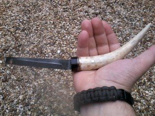

Lately I've become somewhat obsessed by crooked knives and am now up to three.
All have a different 'feel' in use, but I haven't really come to drastically prefer one over the over, at least not yet.
First is a Ben Orford that I had originally borrowed but then purchased
This one has a blade by FGYT, handled by myself
And this one has a blade made by jojo from a file. I made the handle from caribou antler.
Let's see yours please:)
