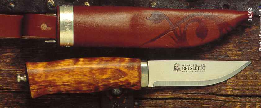

One of my favorites is the Brusletto Norgeskniven. Classy knife that will do everything a good bushcraft knife is supposed to do.
