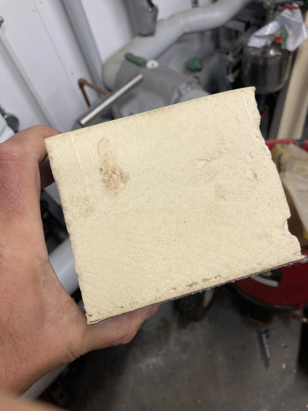

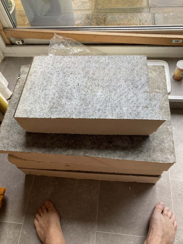

I had a quick skim through my O&M manual but couldn’t see the manufacturer details of the insulation but here’s another bit so you can see how nice and dense it is and the thickness. I use four sheets in the stack.

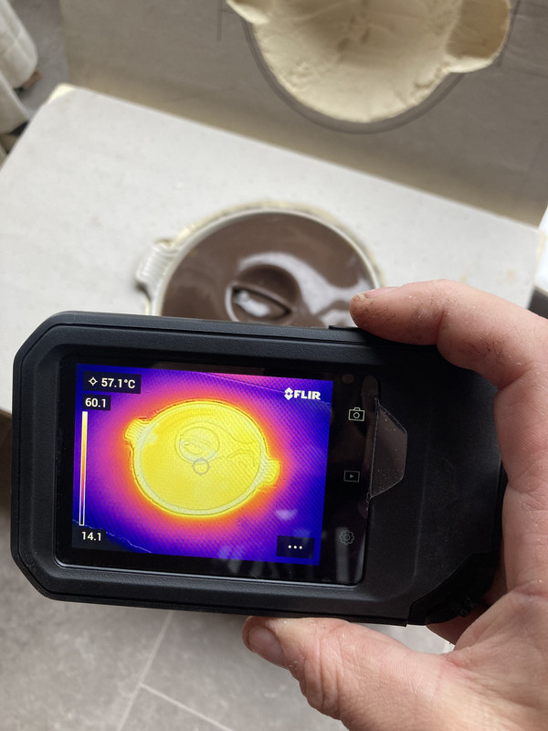

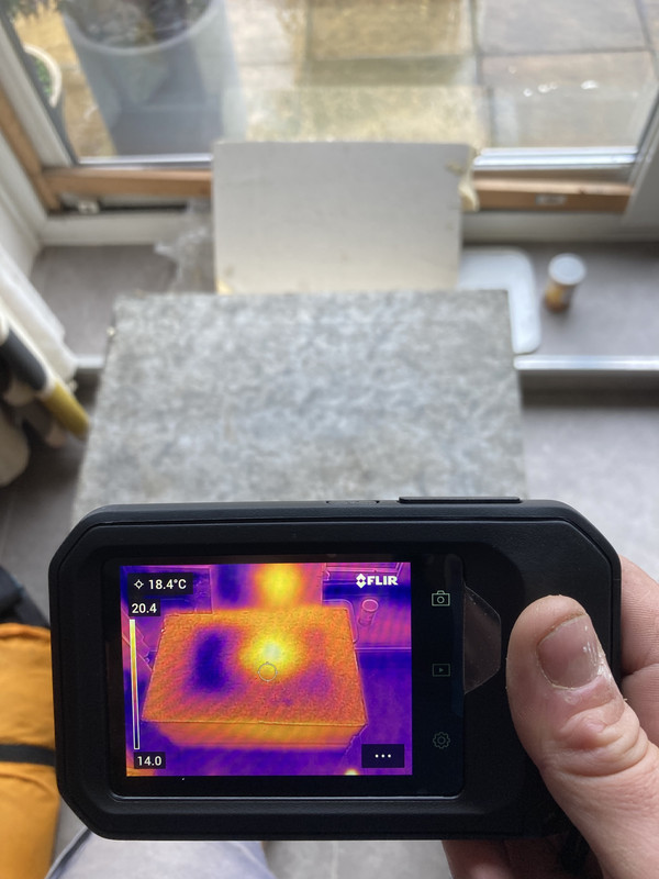

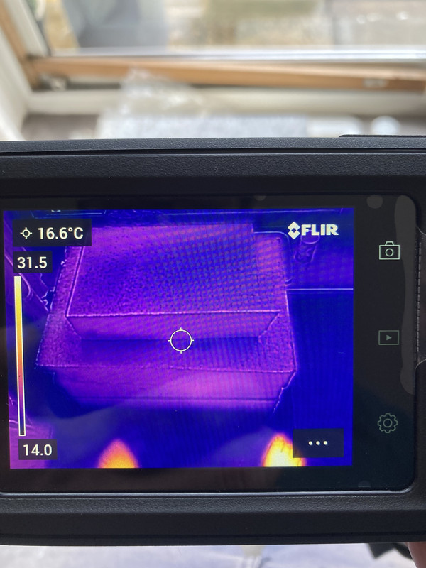

Then another two hours after:
