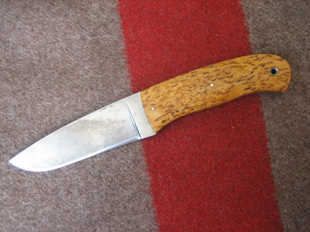

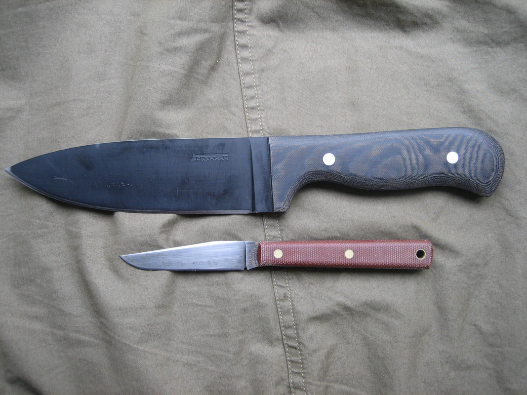

Random camp knife sized things in tough steels to drool over:
Brian Goode O1
Stuart Ackerman O1 (The tiddler is in 1095)

You might contact Stuart Ackerman - Zackerty here. A bigfan of AEBL, also the author of the Serrata and Sustain/Slither.
I bought one of these O1 things from him a while ago. An unspeakably accomplished knife that I recommend to anyone who is looking for a recommendation. He may still have some.
Brian Goode O1
