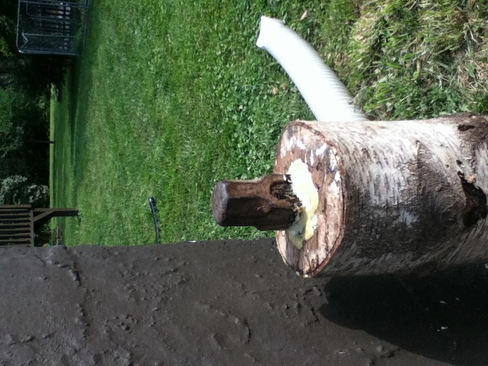

Today I finally managed to get hold of a big enough sledge head to act as an anvil (50p at the boot fair) so I had a go at rigging up a back garden charcoal forge.
Brake drum fitted into a BBQ with electric pump air flow from underneath.
Used a 1 1/2 lb ball peen hammer (that I also picked up today for £1)
1kg of charcoal and a 50p file later...
https://www.flickr.com/gp/135799346@N03/Jq7XV4
not just need to fiddle with securing the "anvil" and rigging up a better air supply.

Looking good. If air flow is your problem try your supply coming in from the side angled toward the wall of the forge, the air will vortex round the inside and you'll get more even heat. I ran into that same problem. Heating directly under I got a big hot spot in the middle and much lower temperatures around the outside.

Drill/chisel a large hole in your stump and insert the hammer head. Then backfill with silicone caulk, masonry adhesive, etc.
You can do a ton of work on an anvil like that, so don't feel like you need a fancy shop to make some really nice stuff. The most important thing about an anvil is having the most mass possible directly under where the hammer hits. A lot of mass three feet to the right doesn't do you any good because you're not hitting three feet over to the right.
If you sink your stump into the ground so there's zero wobble and bounce, that sledge head will act like a 60b anvil.
