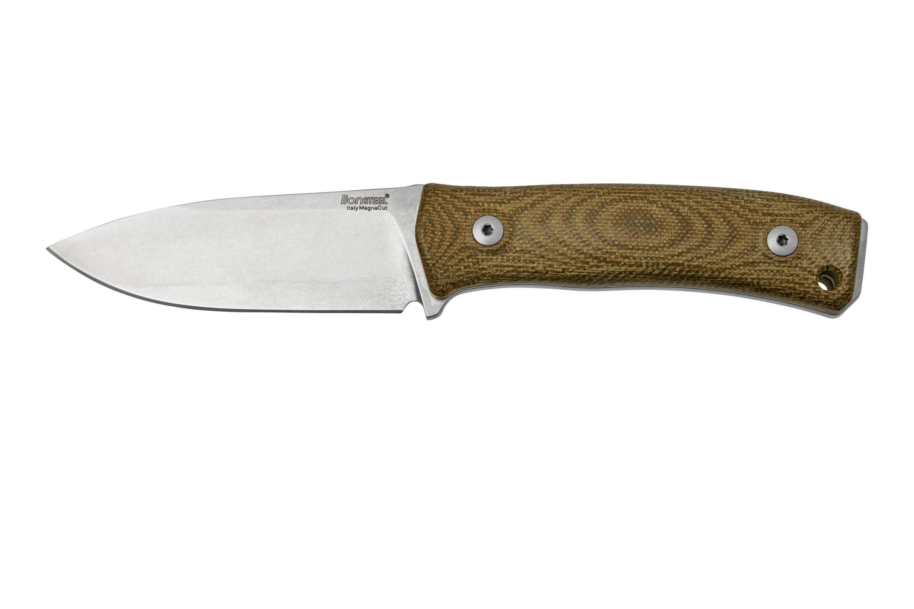

If you like the Puukko, and the F1x, have you looked at Lionsteel? The M4 even comes in Magnacut…although not many handle options left by now.

M4 also available in M390
The T5 or M5 might work better for your chopping criteria.

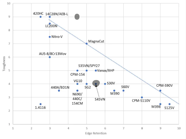

Have you been on https://knifesteelnerds.com/? Good place for steel comparisons.

Rope cutting has very little to do with how good a knife will be for wood working. High abrasion resistant steels tend to have high volume of carbides, which tends to lead to poor edge stability at lower angles (S30V, in my experience in 4 blades by 4 manufacturers). Magnacut is good because it has high edge stability while maintaining corrosion resistance and abrasion resistance. AEBL is not abrasion resistant in rope cutting, but has high toughness and edge stability, which allows for low angle edges and thin geometry. No chips on 12dps edges, for instance.

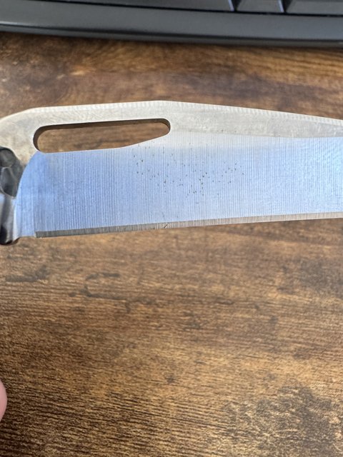

I did see this previously, but it's a bit confusing. Corrosion resistance on my newish Surge 420hc should be 8 according to graph, but after light use around house and trip to Spain where salty water wasn't involved I see already rust specs. It's always stored in a pouch and kept dry. Strange...
Corrosion resistance of 3V is 5.5 and Elmax scored 8 out of 10, so again according to the Larrin's graph 3V is a better than Elmax (same as S45VN on the graph) by quite a bit, only loosing on edge retention slightly and obviously corrosion resistance being non stainless.
