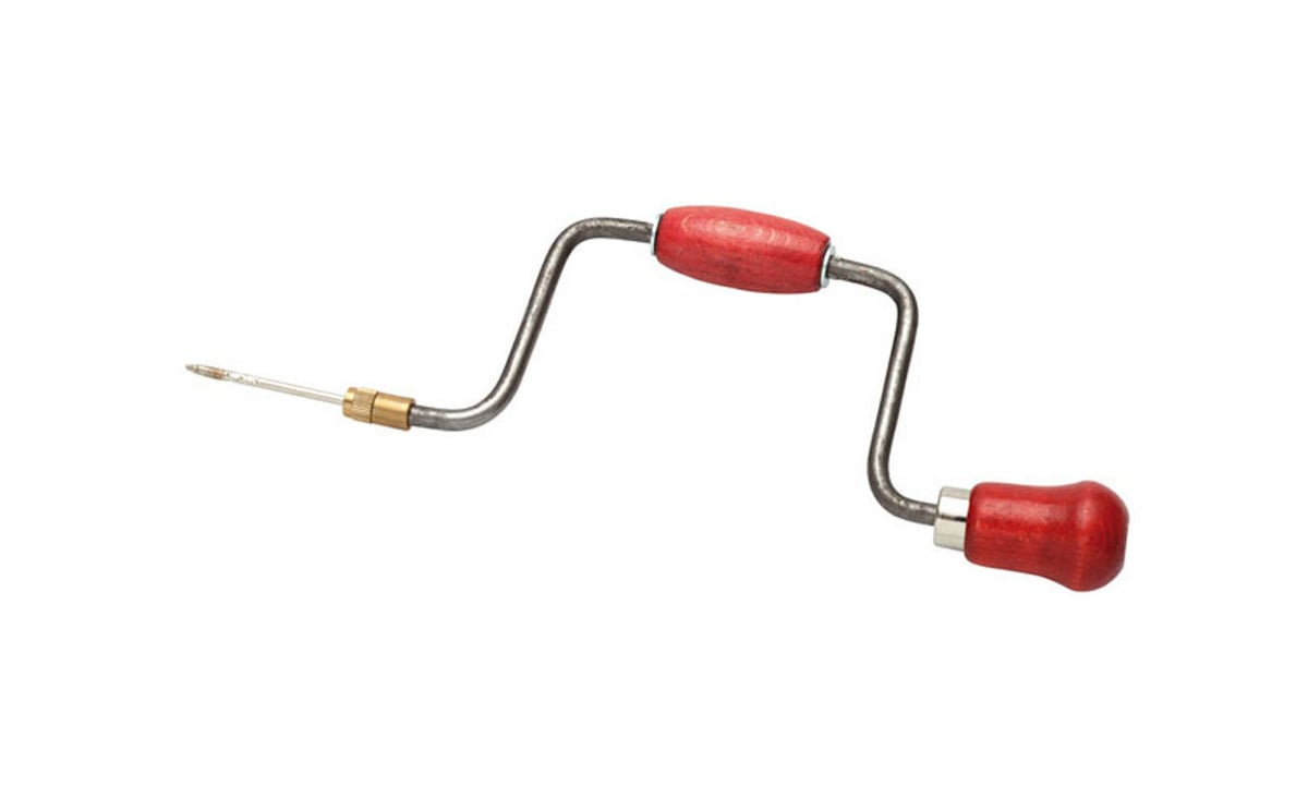

As you know my opinion is that even the drill awl at the SAK is as well designed as useless, because I would need it only to make Ski poles, what I don't do.
But would I want to drill little holes in the forest by hand, I would of course think about a bow drill system.
I am no specialist, but I think it was done like that before they invented the hand driven drill machine, which is relatively heavy but should be for some uses stll a good idea.
You need a German one of course:
Reactions: Minotaur
I have seen on BushcraftUSA them doing that with a flatten ended nail in the end of the drill part.
Lol not sure anyone makes an English one anymore.
Wonder were the hand brace sets in drill history?
Reactions: Erbswurst

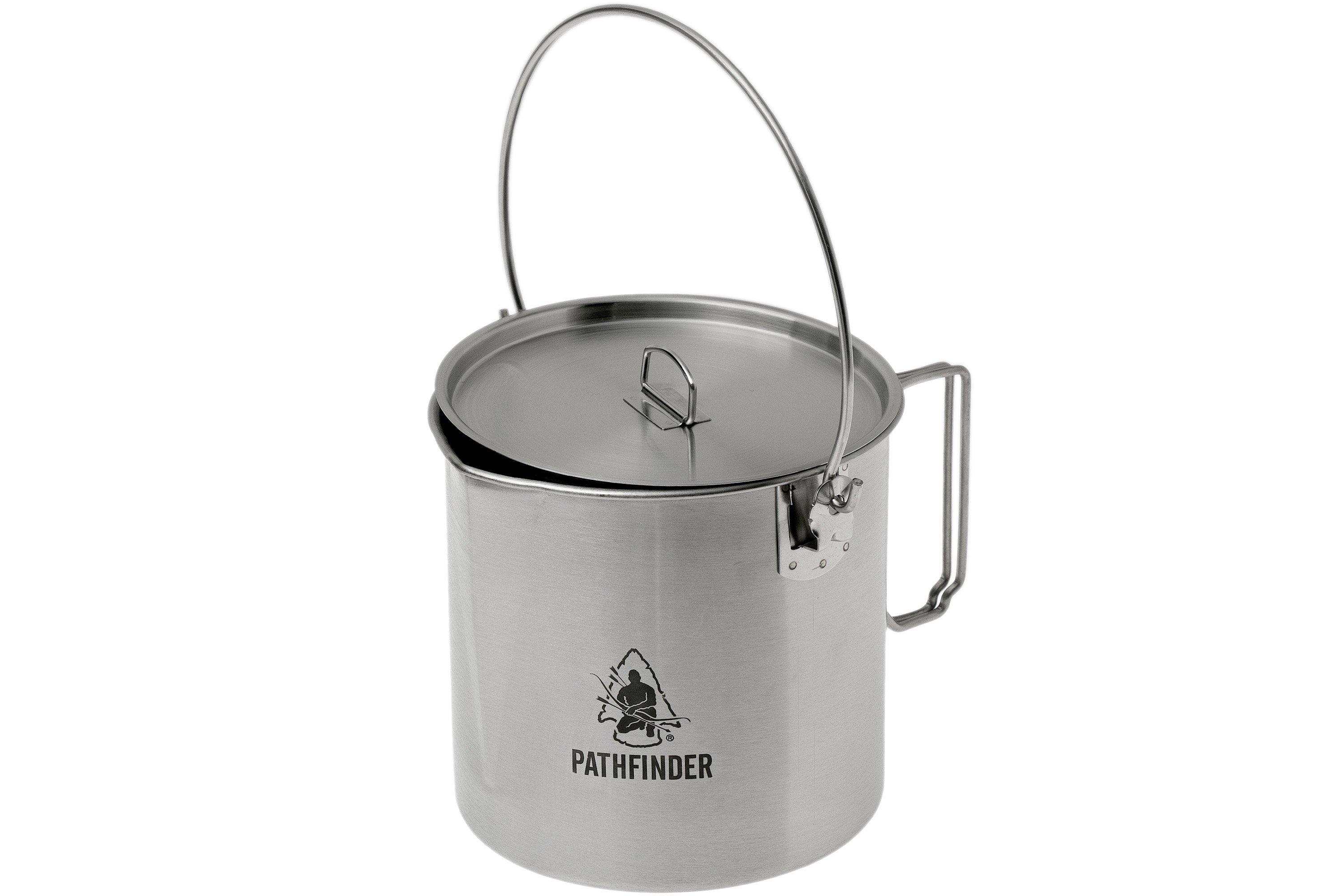

There are types of ground that can catch fire or embers.
We have them in lower Saxony for example and in east German pine woods we have to pay attention too.
But usually I just look for sand and ignite my fire directly on it. Stone would work too of course. If I can't find a secure ground I simply don't ignite a fire there.
In my opinion a pot needs a bail to hang it under a tripod over a fire. Everything else may be a trekking or mountaineering pot, but is no bushcraft pot in my opinion.
There are a few other pots with bail on the market of course, but these here seem to be pretty practical, as they have the butterfly handles too:
Pathfinder Bush Pot 1750 ml
Lixada mug 750 ml, stainless steel
Reactions: MrEd and Minotaur
