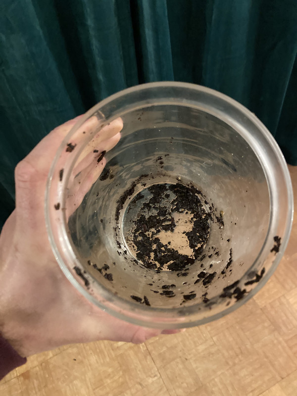

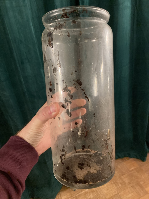

I have found a container that should be perfect and possibly one that’ll be acceptable in the house (maybe!)
