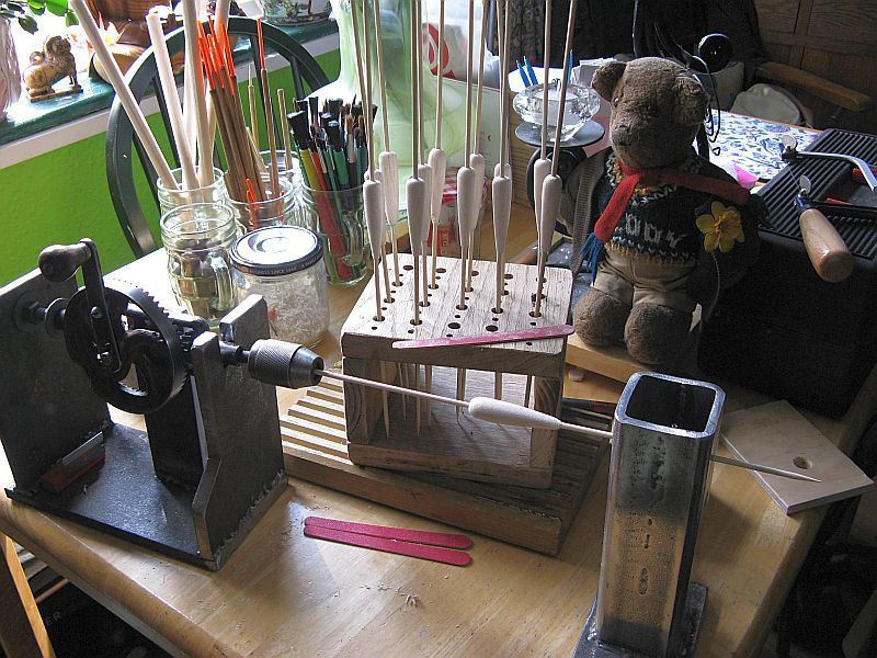

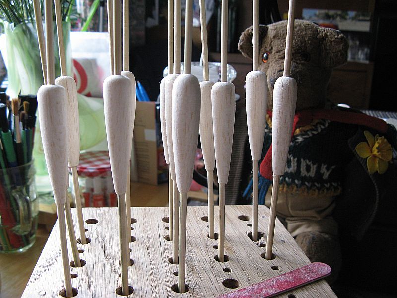

As I learn to use the new Whipping tool, it turns into a lathe
01_zps16c1dvrn.jpg~original
With some 1/2" Balsa dowel drilled from either end
01a_zpswtr1zcml.jpg~original
then a BBQ squewer pushed through and super glued
02_zpsb2gixl6f.jpg~original

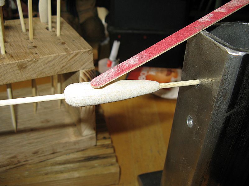

shaped/sanded with a nail file sandpaper board

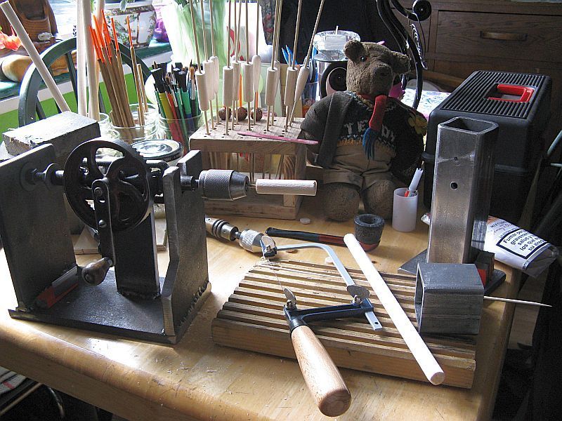

03_zpsq4kq70wx.jpg~original

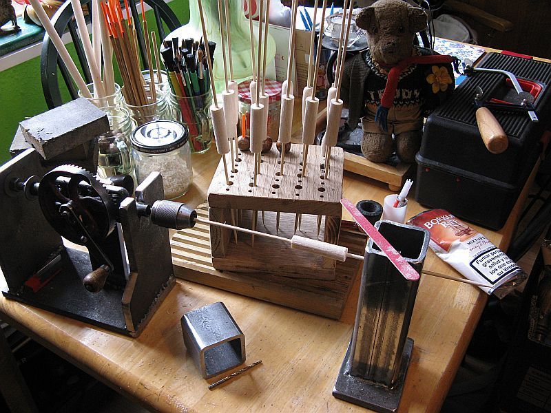

04_zpsyateakf5.jpg~original

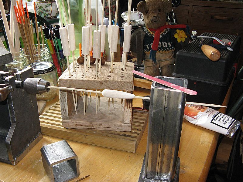

05_zps1t1szmz2.jpg~original
05_zpsdk69qbg3.jpg~original

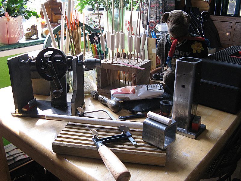

06_zps08flb9fn.jpg~original
it's work in progress
