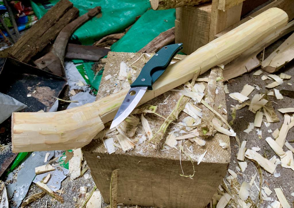

I put a (crude) “true” scandi edge on it and whittled a couple of try-sticks/trap triggers:
Carves beautifully with the zero edge but it may not hold up, being a stern test of micro-chipping in relatively high carbide steels:
Roughing out a serving spoon type thing:
Feather stick
