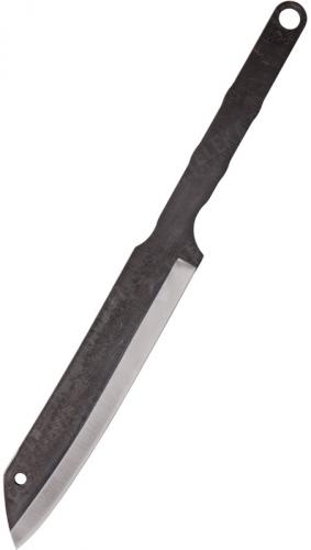

If the 200 blade blank still looks like this,
Looks like the easier to rehandle.

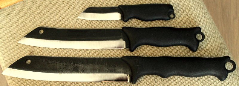

My small collection.
Between the 240 and the 200 the main difference would appear to 'just' be the handle length - double handed width or single hands with. As you have the full complement can I ask what you've discovered? Obviously longer handle is better for generating more leverage and chopping motion but which of them do you use most? ie Do you mostly use the 200 over the 240 until the 240 is most definitely needed??
Hope the question makes sense? Maybe not..
Don´t use any of them much, just bought them because I want them. But for me the Skrama 200 seems more practical to carry on my chest rigg = shorter and lighter. And the mini-80 comes along as a pocket knife.
