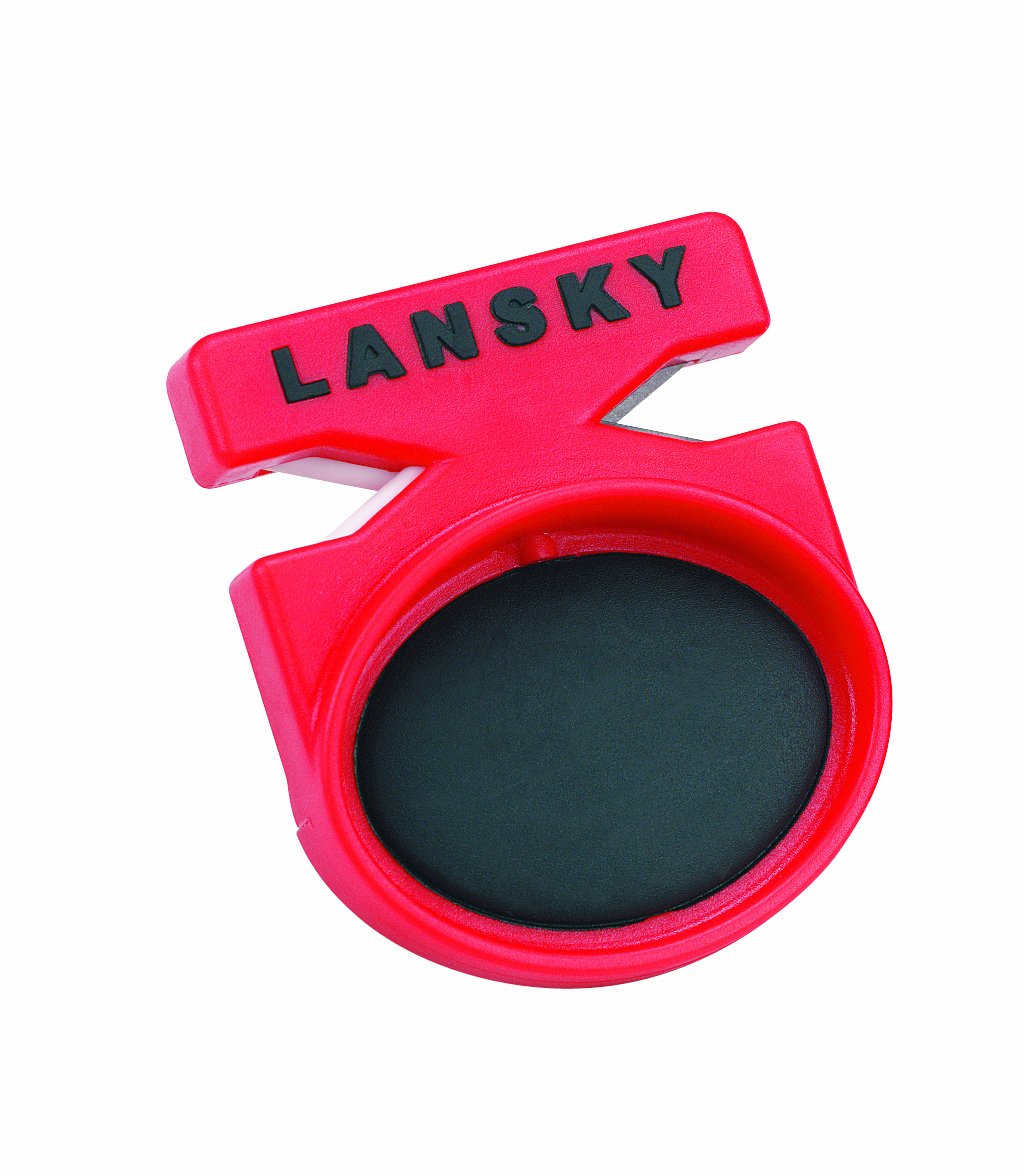

I'm now going to share a big secret which I'm actually a little ashamed of... I usually use different stones to sharpen my knives and leather to strop them to maintain the edge, but for the Opinel what works best according to my experience is... *sigh* This crappy little thing here:
http://www.amazon.co.uk/Lansky-Sharpeners-Quick-Fix-Red/dp/B000B8JDT0/ref=sr_1_16?ie=UTF8&qid=1429525613&sr=8-16&keywords=lansky+sharpener
It really almost does damage to any other blade but for some strange reason it seems to like the Opinel and does not take away the original grind. After pulling it through a couple of times and going over the strop a little, the thing is razorsharp again.
Now I'm getting ready for the beating :D
