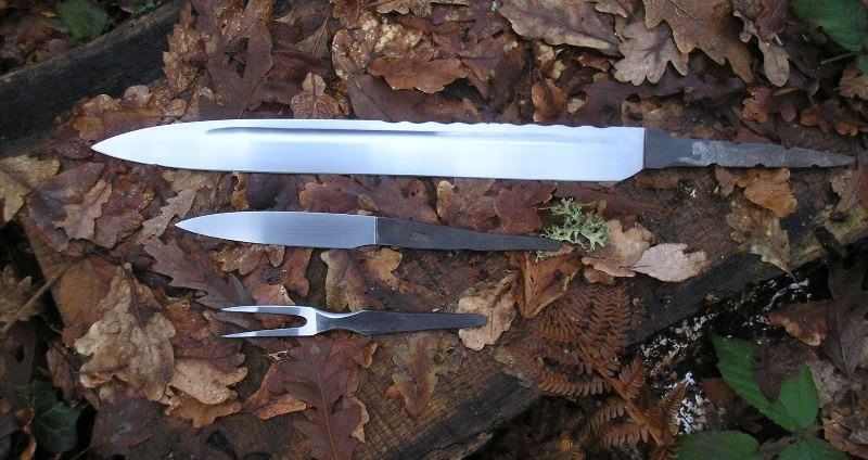

I've only made a few blades with one and I've normally used a scraper made from the end of a file. basically on an annealed file, cut/grind/file a W shape with one of the legs (th tip of one V if you like) slightly shorter than the other. The shorter one is the cutter and can be filed to a point or radius, file it to a 30degree bevel. Then heat it up and bend the new ends over to about 90degrees (the tool is not L shaped with the modified W on one end). Harden it and use as a scraper. The long leg runs along the blade spine of your knife to act as a guide, the short leg carves a groove into your annealed blade.
The to clean it up post heat treat use the scraper again if you can or wrap wet and dry paper around a shaped dowel :)
Or you could use a dremel of course :D
this is a set of blades I made for a friend a couple of years ago. No sgian dubh (though I have been meaning to make one myself), the fuller on the dirk was carved witha scraper and coz it was too narrow for my liking I opened it up with a drum sander on the dremel. Cleaned up with a shaped piece of softwood and wet'n'dry.
