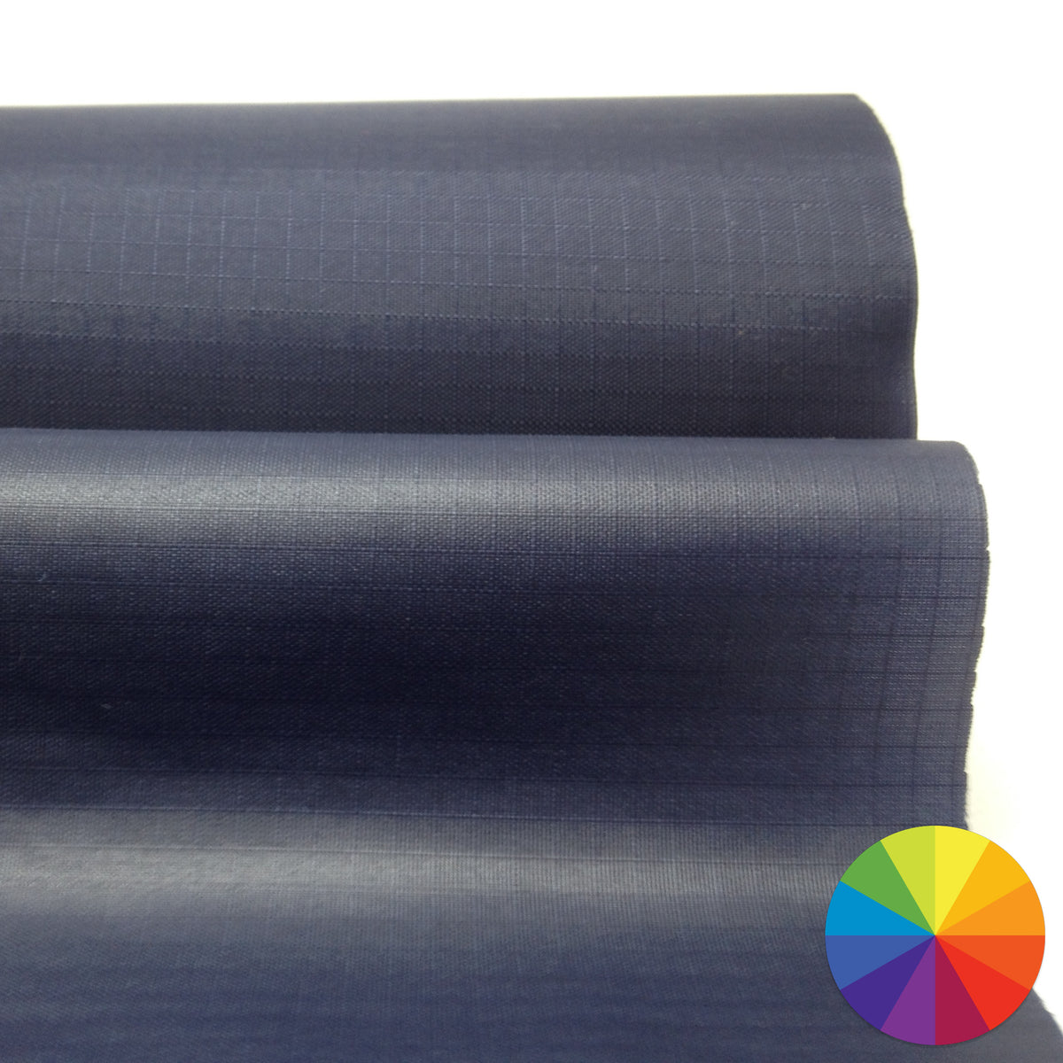

We call it 'ripstop nylon' but it's often polyester. The criss crossing threads can be either.
Polyester fabric and polyester threads are commonplace
Nylon not so much these days.
Nylon thread is harder to find in fine weights. It's fairly easy to get hold of in a weight suitable for webbing, canvas, etc.,
