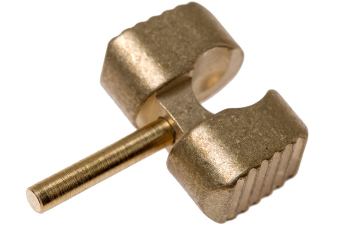

So the failing ball bearing cage fell apart in use, good thing is nothing lost.
Had a quick look at knivesandtools.co.uk and ordered the brass
Ball bearing cage....cannot wait to do the repair
Watch this space, I will post an image of the fix
Reactions: Nice65
gra_farmer
Mar 29, 2016
1,834
1,042
Kent
So the brass ball bearing cage came for my manix today, after putting the babies to bed, and while my lovely wife was watching 'married at first sight' I got to work taking the manix apart.
Now I wanted to take a few pictures, but the fix was so quick and simple. So here is the finished repair
The brass looks great, so really makes you wonder why spyderco use plastic?
A really simple fix or upgrade for every manix fan, it is a little stiff to unlock the blade when flicking out the blade, but should break in nicely.
I got the part from knivesandtools.co.uk, if anyone else wants to have a go.
