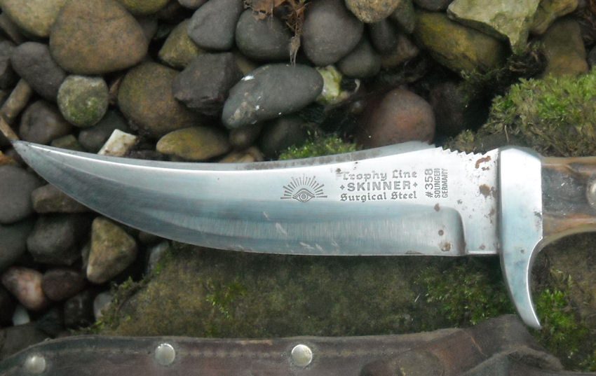

Someone has obviously tried to put a deeper hollow grind onto it at one stage of its life but other than that and some superficial rust, and one slice in the belt loop on the back of the sheath, it's in pretty good condition throughout.

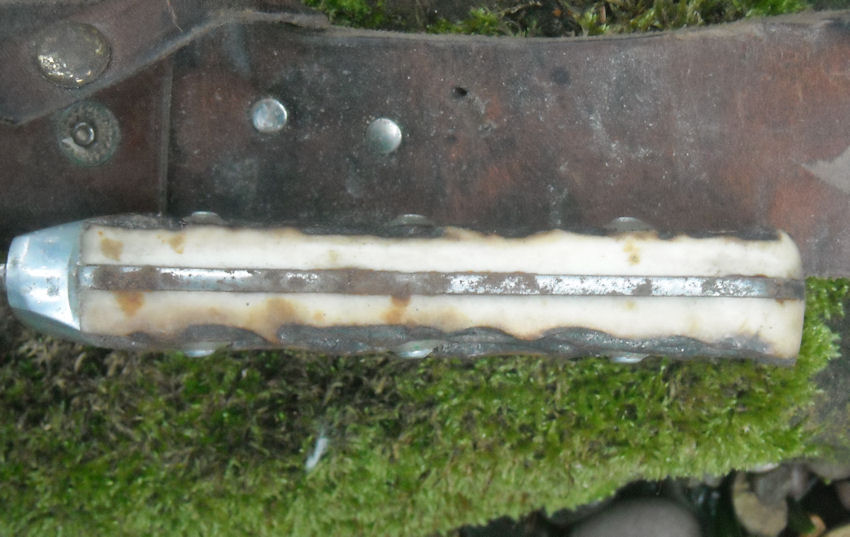

The stag scales are solid with no cracks or dings.

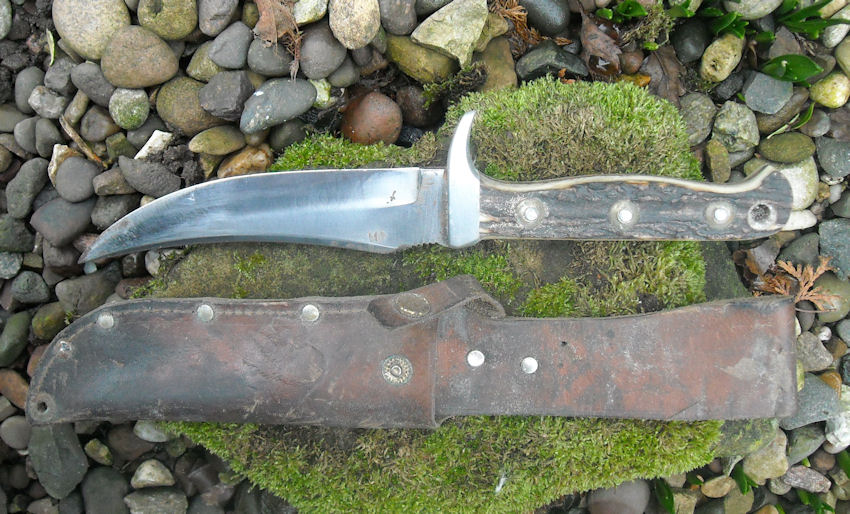

I have one of these knives up at the cottage and I use it often on deer and geese. An upswept blade isn't everyone's cup of favourite beverage but they work superbly once you get the trick of them.
I plan on a full restoration and this one will become my working knife at the cottage while the one up there can go into storage for Charlotte, or for her kids one day perhaps.

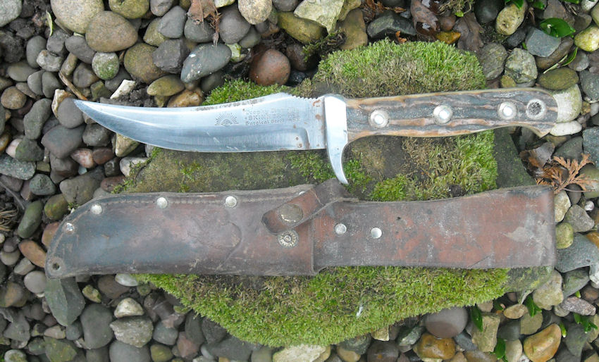

Here we go (sorry about the rubbish picture - it's a horrible day outside):
400 grit vertical sanding on the guard and on the flats of the blade and 400 grit horizontal sanding on the bevels.
Edge is stropped and scary :cool:
I also did a 400 grit rub around the spine so that it's all fresh steel with no witness marks left from rust, but I didn't touch the Stag scales.
Stag looks silly freshly sanded and takes ages to darken down to the condition these scales are currently in. Why spoil a good thing ?
:rolleyes:
I didn't take the bevels any higher than 400 grit because it's blimmin freezing outside, so I'm stopping at this stage and the knife is now in full on user mode - I will retire my own Puma knife up at the cottage and put this one into active service in its place.
Total cost is under 3 hours of my own elbow grease and four sheets of wet and dry.

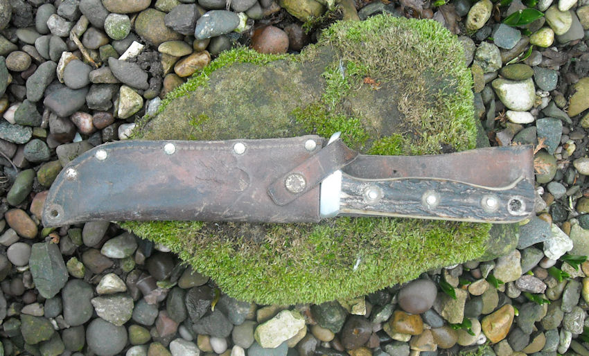

I will have to make new sheath for it though - the original smells of some sort of synthetic oil and it's just about had it. Still, you can't have everything for £9 :rolleyes:
