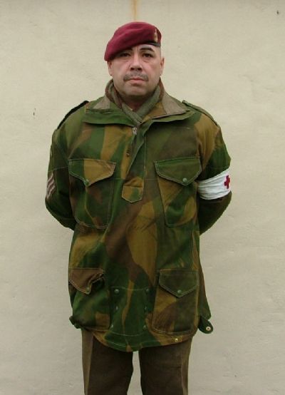

This is the camo i want to reproduce.:cool: (but not the hat!:yuck: )
(i'll have to watch how i put it together as looking at the photo the guy has a really bad straight line join on his back, as many soldiers/hunters know "there are no straight lines in nature".
This is a denison design(don't know which,or if it's real).

Yep thats the one i thought you meant,(i have that book) if you look on the pegasus link they do the pure white snow version exactly the same pattern as was the desert/and mountain versions, only the 1st pattern densions where hand screened/painted and each was unique, but you could do a very similar job for your windproof, if you look at the left knee in the pic (front view) and right shoulder/and ankle in the rear view pic you can see where they have a brush stroke effect i would use a very pale tan/or khaki material for the base colour and then add the cammo colours or your choice with a soft horse hair paint brush and maybe a natural sponge to give the desired swirls and dabs, good luck, wish i had the equipment to give it ago myself a one off cammo smock to suit your needs is a nice idea.
