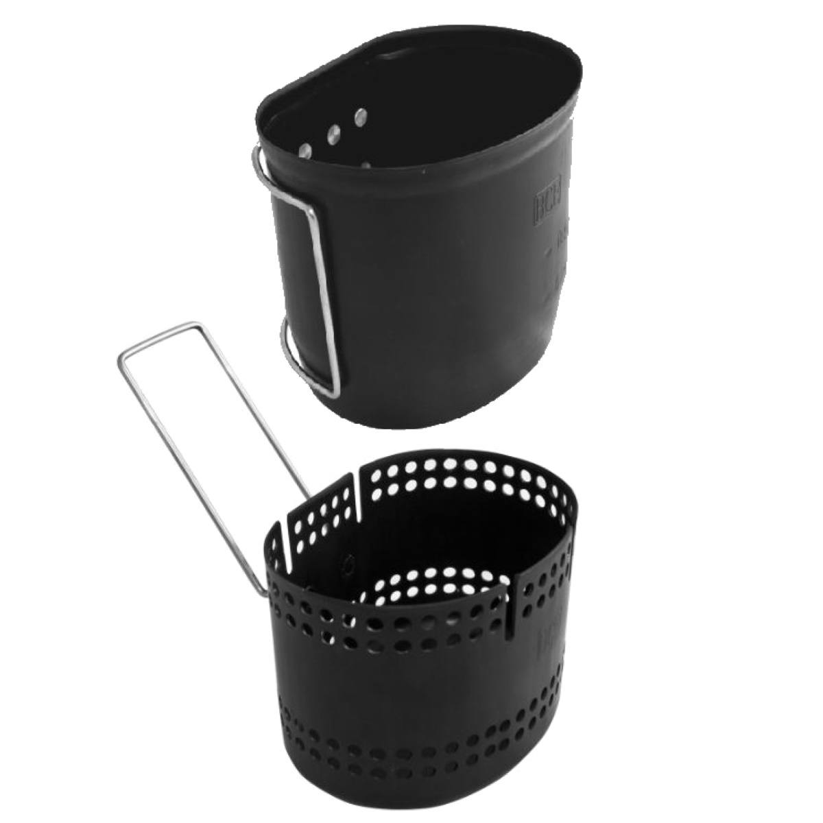

How about one of these
I have a similar one in titanium for an evernew burner.
