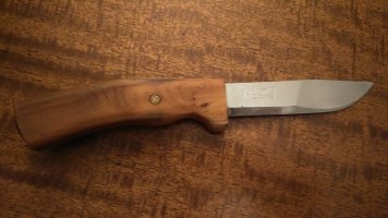

How did you manage to remove the HVK blade so cleanly out of the handle Kepis?
I think on that one i hammered the knife into a log, then put a stick against the front of the handle and knocked it off backwards, then wiggled the blade out of the log. The other way i do it, but nowhere near as much fun, is to hold the handle in a vice and run an old chisel along the top of the tang, making sure the knife blade is well wrapped in tape for safety of course.
EDIT: yup its the one i hammered into a lump of Oak
