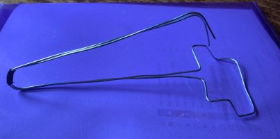

Do you have a wire handle on your domestic grill pan?
Make something similar out of 2.5mm garden wire (£2.90 for 5M)
I’m up in the hills or I’d make one as a demo.
I don't have a wire handle on my grill pan, and I've been trying to make a wire handle from a coathanger. I can't get it to work!
I did make one when I was about 10 /11yrs old, along with a treacle tin Billy, and a coathanger wire toasting fork. I used coathangers for each project.
My memory refuses to tell me how I made the fray bentos handle, but I have a strong recollection of using it in the garden camp I had, to cook eggs. The Billy to make tea, and the toasting fork to make toast. It was something I did frequently. My camp was beanpoles made into a tipi with old curtains as a covering.
I can see all vividly..apart from that danged bentos frypan handle!!!!!!

Right!-
I really ought to be cutting up plastic tubing and boring corks for all the hours there are but:
This is only made out of 1.5mm tying wire - very soft but it tests the concept.
It would just about lift your tray but not with a couple of rashers being shaken in it.
Make it out of 12 gauge fencing wire or similar.
As shown it is little more than a pot gripper but:
If you curled the ends back and cut them short then bent the edge of your tin tray inwards the handle could hook under and be more secure. However, you’d end up with a cleaning problem.
Best solution would be to drill two wee holes, 25mm (1”) apart, near the rim of your pan and hook the loose ends back through. If you made those loops big enough the whole handle would fold forward for packing.
Fiddle around with the angles until the handle sits where you want it to.
It might be possible to fill the gap between upper and lower parts of the handle with a branch and tie it all up to be pretty.
However I’m an adequist and can’t be bottomed. If it works, it works!
