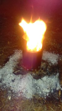

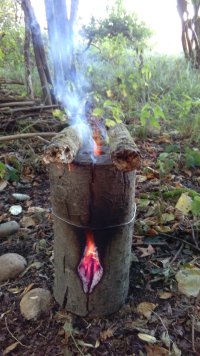

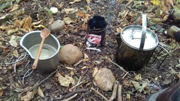

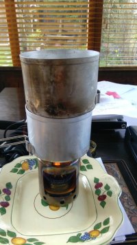

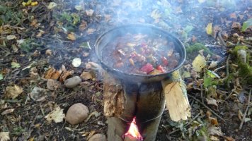

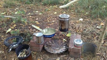

My most recent model - it lives up in the woods :)
Made from a cutlery drainer with bolts for legs
View attachment 96335View attachment 96336View attachment 96337View attachment 96338View attachment 96339View attachment 96340
Ah, the ' Ikea ' hobo stove as I do recognise that firebox to know I have bought a few for that purpose and I have found various charity shop stainless steel coffee/sugar/ tea kitchen containers for the making of the ' Greencraft ' Bush Pot
Make your own Bushpot - Greencraft
