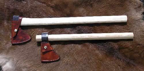

Well, having got the axe bug recently I felt obliged to make some without the use of excessive grinding :yuck: so in keeping with my preference for a forged finish I have stuck at it and am beginning to get the hang of forging these to finished :approve:
Here are a couple of commissions for members here. I s'pose I should let them know that these are done now :rolleyes: I've got a couple more hawks to finish next week too.

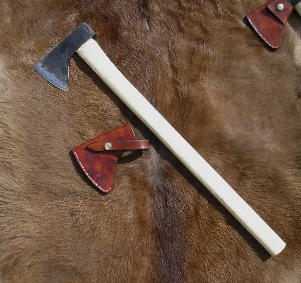

Edge Length……. 3 ¾”
Head Length…...6”
Head weight/ Total weight…...560g (ish)/925g
Handle Length…... 24 ¼”
Blade………1055M, forged finished
Handle…………..English Ash (from my woodland)
Furniture………...Yew wedge
Sheath…………….Brown leather mask

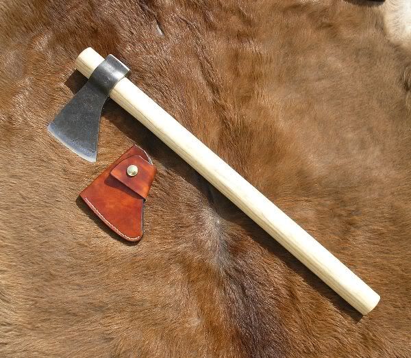

Edge Length…….3 ½”
Head Length…...5 ¾”
Head weight/ Total weight…... 550g (ish)/ 816g
Handle Length…... 21 ¼” (total length)
Furniture………...N/A
I've left the handles a little long so if the new owners feel that they could do with shortening, then they can do ;) Another advantage of a straight handle there!

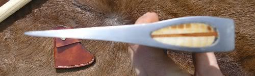

Nice work Dave I like the natural finish. The top one has a similar profile to the Norlund hatchet i did up. Any chance of a end on view, i love axe porn:D
mark
Nat,
Axes are something that I've done on and off over the years, but due to the hard work involved I've not made all that many. Recently though I needed a procrastination project (that didn't focus on my other work) and with the flypress it's not quite so bad anymore :) There are a couple of other threads that I put up recently on my axes (one is a tutorial on making one)
They are still a lot of work and I doubt I'll sell many partly because they won't be cheap. Unfortunately people think axes should be cheap yet knives are allowed to cost a fair price, despite the fact that making an axe is harder work, costs more in materials and takes the same amount of time! :dunno:

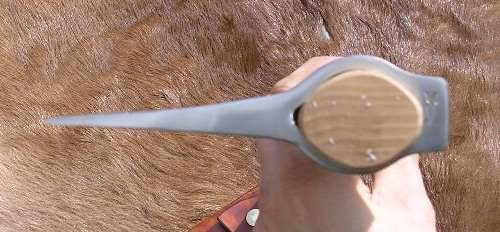

Mark, just for you...
the wedge in the top one was a job to get in as the head was such a tight fit to begin with, but that's a good thing :)

The hawk in the picture is my first attempt at one, so I was pleasantly surprised at how quickly the handle came together, thus cost less at the end. Of course that could've been beginners' luck and the next one will take twice as long! I've left these handles with a carved or scraped finish just as I would do my own. It feels a bit rough if you are used to shiny Granny B's but you get much better purchase on the handle so is safer and less tiring to use; with use it smooths out anyway. It also saves a couple of hours and sheets of abrasives :D

I really should make one for myself to see how it performs ;) I like the idea of hawks for throwing axes certainly (thicker easily replaced handle) but I wonder if the wide eye would get on my nerves in normal axey use?
