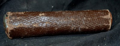

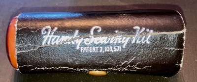

I no longer have this, but a vintage sewing kit that I did have was made as a roll.
It was the diameter of a 1000yard reel of thread, and was two and a half reels long. It held two reels in a kind of deep half moon shaped end and the leather continued enough to wrap over and stud closed.....well, it wasn't a stud as we now think of them, it was a Sam Browne stud, a brass one that fitted into a slitted round ended hole.
Basically all that needed stitching was the two half moon end pieces.
The space between the reels held a round pin cushion, a measuring tape, a tiny pair of scissors and a thimble.
I'll see if I can find some photos of vintage hussifs like this.
Sounds like an excellent present :)
Not like mine, but very do-able :)
This one is more like mine, but mine had sewn in ends.
This one's nice, different again :)

Thank you Toddy, that is perfect, I think my own spin on the last link is just what I wanted....lets see if I can do this now
