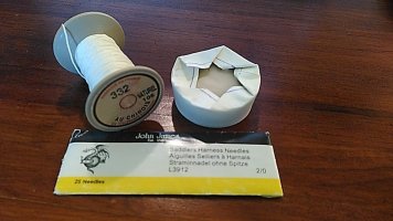

Looking for thread to stitch Leather
True but if needs must it could be unravelled I suppose or just make the holes bigger?
I have no idea the size of mine certainly thicker than waxed linen, however I never count anything out
While butchers twine is strong, no arguments there, Linen is more durable, even when not waxed as cotton (butchers twine) has far more stretch/contraction than linen does, which makes it a weaker choice over time. Cotton will work well enough if its never gonna get wet though.
