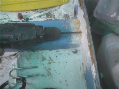

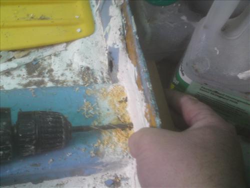

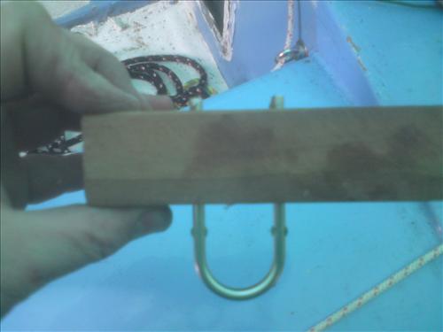

Need to keep it as close to the floor as possible to make the loading transfer to the floor beam, rather than the bulkhead under the hatch, where there is no strength.
Need to drill two holes to let this in.
No Idea
Sep 18, 2010
2,420
Dorset
That panel was bending just under the weight of me drilling through it carefully.
This hull is really soft.

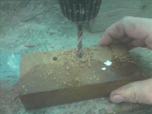

Marking the position of the holes in the hardwood....
No Idea
Sep 18, 2010
2,420
Dorset

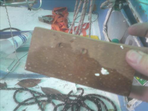

Had to mark it offset so the bung will still go in.
Being very carefull not to let the drill go through the wood and the hull....
Probably not the best thing to use as a workbench...

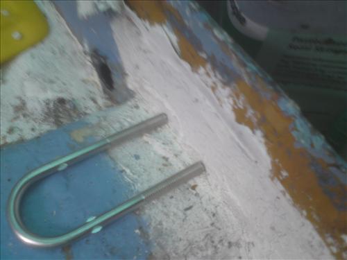

Checking the U bolt will actually fit through the wood - BEFORE I hammer it in in the boat and get it hopelessly stuck.
