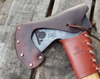

Here are a couple of results from ebay, actually found them by mistake when I searched for "leather bushcraft sheath"
Definetly more satisfying and enjoyable to make your own.
Reactions: punkrockcaveman
There’s a gent on Etsy goes by the name of petko leathers, I have Just got one of his sheaths for my kansbol and one for my 106, and il be ordering a mask and collar for my hb 006 (as soon as the wife’s forgot the last lot) hes got excellent leather and great service, tracking info with packages etc, can’t recommend him highly enough, etsy can be unreliable at times but I’ve found this chap solid, hope this is useful - all the best to all.
