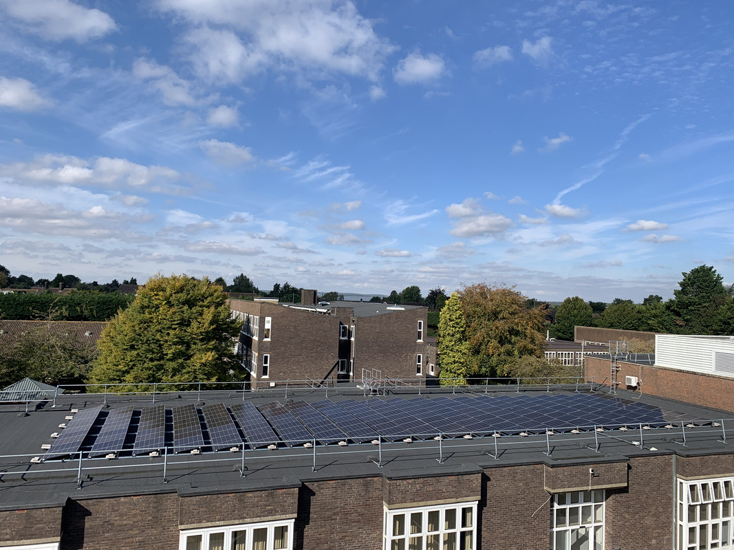

I’m still not sorted on my home setup but I’ve just had 50kw system installed at work. It’ll be expanded to 60 soon and I’m also going to have another couple of arrays the same sort of size installed.
None of it will end up going back to the grid!!
That's impressive!

I have put 10 panels up and another 20 will be ordered soon to bring it to 15kw. Once I have replaced a Portal frame building roof, I will then flood that too, with the aim of 30kw of panels in total....I am doing the installation myself with a help of a friend, so a little slower than usual...
Do you plan to use all the 30kw when it's sunny enough to max our, or sell it back to the grid?
Also, do you have an idea what a 30kw setup would produce on say a winter's day with a bit of sun and bit of cloud?
I have three phase so can sell / feed back 11.8kw without argument with UK power network / grid. I will be requesting an extra 10kw, so about 20kw, if the local network can take it. I will also have 30kw battery storage. But I am planning on having 3 separate 8kw single phase inverters (max 24kw) so I will be over loading them, and a switch over 6kw power system at 12v.
The feed in will be an unbalanced 3 phase system, otherwise I would have to change my inverter idea, from single phase inverters to a separate 3 phase inverter. I already have an 8kw inverter, thus thinking about keeping it.
As for your question, on a winters cloudy part sun day, with a 30kw panel system, I would be likely to get 3 to 7% of that per hour for about 6 hours, so that will go straight to the battery storage.
Edit - forgot to add
Future proofing the home, I was going to install three electric car charging points, one at 16kw, one at 7kw, and a standard 3 pin plug 64amp rcbo, so I can tailor any electric car charging based upon how well the solar panels are generating.
Reactions: slowworm
