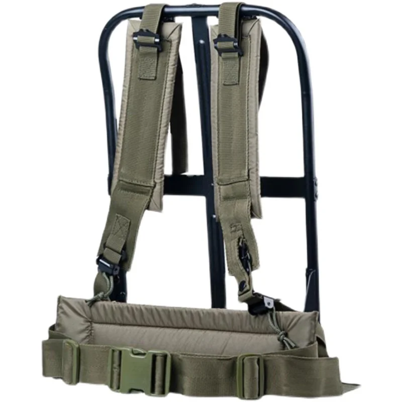

Have you looked at stuff like the Kifaru pack frames (I am thinking of the Duplex, but there may be newer ones). Not suggesting buying one is the answer, although it would be, but they are US based, expensive, and hard to source. However, they make external frame packs for hunters who will carry a lot of weight, like full camp kit, plus meat.
I don't know how you would use the frame design to do your own, but it is one thought.
The other end of the spectrum is the Roycroft Pack Frame.

If you’d consider buying a pack frame, Tatonka’s Lastenkraxe is very sturdy and stands up for loading.

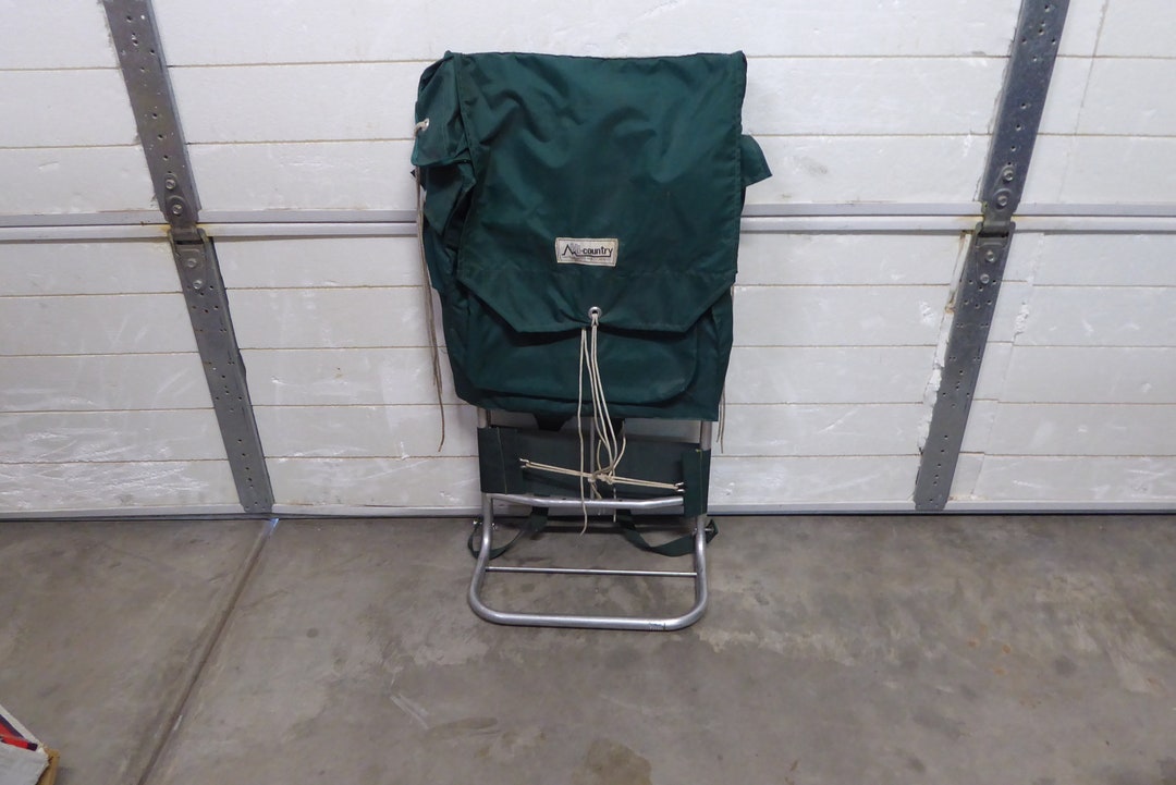

I wonder if you could make something from an old chair :)
Pick one up from a recycling yard or a junk shop. Take the cushion off, cut the seat length and refasten the front brace, discarding the front legs, cut the back legs shorter, screw on a couple of angle braces under the (now) shelf. Then just screw on some loops of old seatbelt webbing or similar as shoulder straps. Maybe a bit of padding between your back and the frame.
Pattree
Jul 19, 2023
1,318
737
76
UK
30kg? About a quarter of a cubic meter.
Hmmmm
I wonder if a couple of lengths of 25mm pvc conduit, a couple of metres of 8mm all thread and a handful of butterfly screws could make you a folding “L” frame. Shoulder straps and diagonals of two inch webbing and a bungee octopus to hold your sack in place.
It would buckle a bit to start with but it just might survive a season or two and it’s so easy to make. I’m talking through my bum here but I use 25mm pvc for all sorts of things.
You could probably do everything above for £30. It might be worth a punt.
Come to that - any old charity shop framed rucksack (set as high as you like) with the front cut open vertically and a bungee octopus might work.
Neither idea is elegant but who cares?
