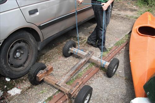

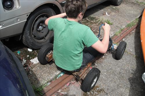

Wheels on this one are running on a piece of pipe thats held to the axle with Ubolts. Always when I was a kid, I would use bent over nails or bits of wood screwed on.

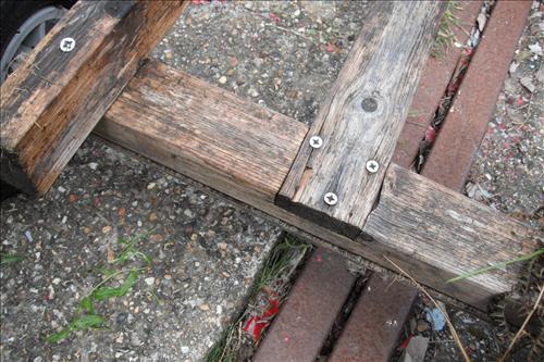

Back axle is secured to the frame the same way. The frame is jointed at the back. Discovered just nailing one piece of wood to the other always failed as its not strong enough and is a pig to sit on.
Top piece of wood was laid on bottom piece, two lines drawn, then cut with a saw, before the middle section was chiselled out. 3 or 4 wood screws hold it together.
Ubolts hold the back axle on too. This si Big Ideas Gokart. He built it when he was 12 ish. The wheelbarrow wheels were in a bankrups stock shop for £3 each.

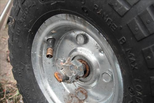

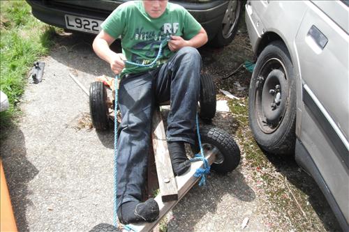

This is Little Ideas gokart. This has sack truck wheels. It has bearings, but its axles are m10 threadded bar, so the bearings are irelevant.

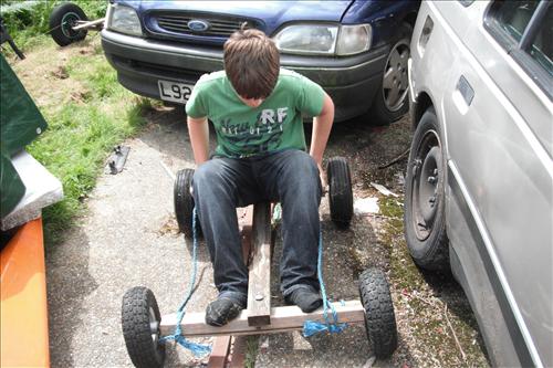

Again, the length is governed by his leg length
Front axle on this one is wider than the rear, simply to give more space when turning for his ankles.

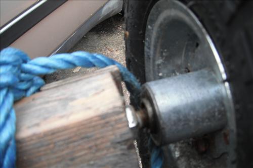

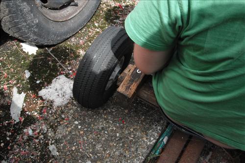

The blocks on the rear axle stop his rear sliding into the wheels on corners.

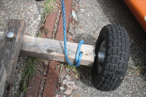

String to pull it..

So long as the holes in the top are drilled, the kids can usually hammer the screws in without splitting the wood.
Drilled hole on this one for the rope. Nails always seem to come out eventually and the rope always ends up tangled in the bearings if you tie it to the inside of the metal axle.

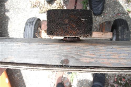

Big bolt for front pivot with a washer in between the pieces of wood. Two washers always seems better. No Idea why.
Axle on this one is chiselled into the 2 x 3, then plywood nailed over the top. The nuts keep the studding in place, so the wheel does not rub on the wood.
Chomped off with 4 ft bolt crops. Little Idea has heard of hacksaws but wont have anything to do with them if he can possibly help it.
Those are sack truck wheels with bearings.
