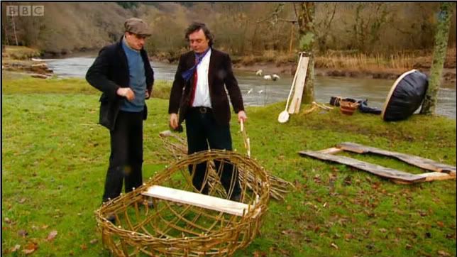

I was on Edwardian Farm, episode 8, this Friday 24th Dec making a coracle. For those of you who have not seen it, it is an ongoing documentary about 3 people who live and work on a farm as they would have done in Edwardian times, 1901 to about 1920.
[/url]
Edwardian-farm, coracles by woodwrightman, on Flickr[/img]
I spent a very enjoyable 6 hours or so with Alex helping him make a coracle, all of which was filmed. During the day's filming I went into great detail about how to make a coracle, but only a brief overview was shown on the TV. If you just want to see the coracle bit, then it starts about 16 mins in, and finishing it off at 20mins, the coracle being used at about 24 mins. I bought the book the other day and there is a small photo of me in it. Being a person who loves to know how things work or get made, Edwardian Farm has been fascinating for me, both Lucy and I love social history. I wish they had the time to go into far more detail both in the book and series, but I know they need to make an engaging and entertaining program. A program that I would love to see would not appeal so much to the normal BBC2 audience.

That looks like a Teifi corracle from the photo - while the one against the tree looks more like a Towy model...am I right?
The paddle seems to be from a different region completely though....
They are not made to any of different river styles, just my generic coracle style. The one against the tree is made from ash lath.
It was great chatting to them Alex is a great bloke with a real interest in craft. I had a chat with Ruth about herbs and rush used on floors. I lived in a tipi and bender for 4 years and soft rush was the floor covering of choice. In a lot old medieval houses the doors had a 4 inch high plank at the bottom so you had to step over the thresh hold, even internal doors. We reckoned that this must to have been to hold the floor covering in.
The figure of 8 paddle stroke is easy to do, the best thing to remember is that you are in fact pulling yourself through the water. Not the fastest craft in the world, I remember that Tim Wade had a go at crossing the channel in one, not my idea of fun though.
They are easy to make, make a basket or bowl shape and put a water proof membrane on it. They appear all over the world in various forms and were also probably one of the first boats to be made. I had one farmer once ask me how much they were, he scoffed at the price and said he used a builders bag with a pallet in the bottom and nailed on some walls and gunwales, and away he went.
If you want more info look up the coracle society on the internet.

The guy who taught me was Bernard Thomas from Llechryd - and he completed a channel crossing in a Tivy corracle!
I did an article (back in the mists of time) for SWAT on building a Bull Boat.
If you come to Weat Wales a visit to the Corracle cnter in Cenarth is a must.
Local fishermen still use the corracle - one is built from Alky piping!
Also draft excluders. Stopping the draft makes a lot of difference.
I might goive it a go, I have made the "classic" improvised version (lash together a ring of small branches, a floor cris-crossing it and a tarp lver the whole thing: http://www.aktivitetsbanken.se/aktivitetsbanken/images/thumb/1/1b/Risflotte.JPG/305px-Risflotte.JPG). Drawbcks for that one is (1) a lot of cord used, more than any sane person carries when out hiking, and (2) that it ends up heavy. A more sane improvised corracle/bull boat would probably be easier to build and take less materials.
I figure using it for small lake fishing is the (for me) ideal use; light so it can be portaged easier than a canoe, and perhaps even cheap enought to be left all season by ones favourite lake (if home made with a plastic tarp or cheap canvas and paint/tar). I wonder how it would be for waterfowl hunting...

Nice one Sean. Like the flowers in the background. You should have showed him how to do a fan bird as well. That would have grabbed his attention ;) (If any of you reading this don't know what I'm on about, look at Sean's blog NOW!)

I love those little coracles. I visited the museum and it's well worth the visit if you have any interest at all in boats. They are the simplest of boats to make and cheap too. I have seen one somewhere, a generic sort of coracle, made with strips of birch ply.
And what about a big, woven bamboo coracle, 8ft in diameter, like this one from Vietnam:
completed with a small diesel engine...Love those basket boats, so ingenious. Now that's cool!

I just watched it on iplayer - a great episode!
The trawler used to live on the Teifi at Cardigan and I have often admired it, though I first saw it in Devon when I was on holiday!
The coracle making looked great - a bit different to how they are made around here where the front is very flat to allow you easy paddling over the bow - it was very much like a cross between how I made the bull-boat and a local coracle :)
