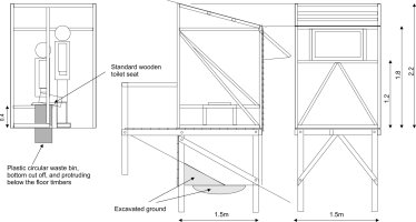

This is a rough sketch of the one I installed in 2017; the tall plastic waste bin (the type you can get for an office or similar) is vital for clean, smell-free, operation. The worst smell that we get is a 'compost' smell; a bit like when you open a new bag of commercial compost. Obviously, the design would have to change for a flat area.
It turned out almost as planned :)

So you compost directly to the ground, not an enclosed cell that gets rested for a year and then emptied after a year?
Broch
Jan 18, 2009
8,464
8,343
Mid Wales
www.mont-hmg.co.uk
Yep, that's the 'tree-bog' principle - theoretically, it never gets emptied. The 'mound' reduces quite quickly in the unused periods. The bacteria, fungi, invertebrate, and trees take out the nutrients. Wood shavings (a small amount per visit) balances the nitrogen/carbon to improve the composting process. However, I have assumed that at some stage I will need to dig it out (in my case from the rear), but that is years off based on the current situation.
It only works where there are plenty of trees or where trees can be planted. They are often surrounded on three sides by new willow growth.
