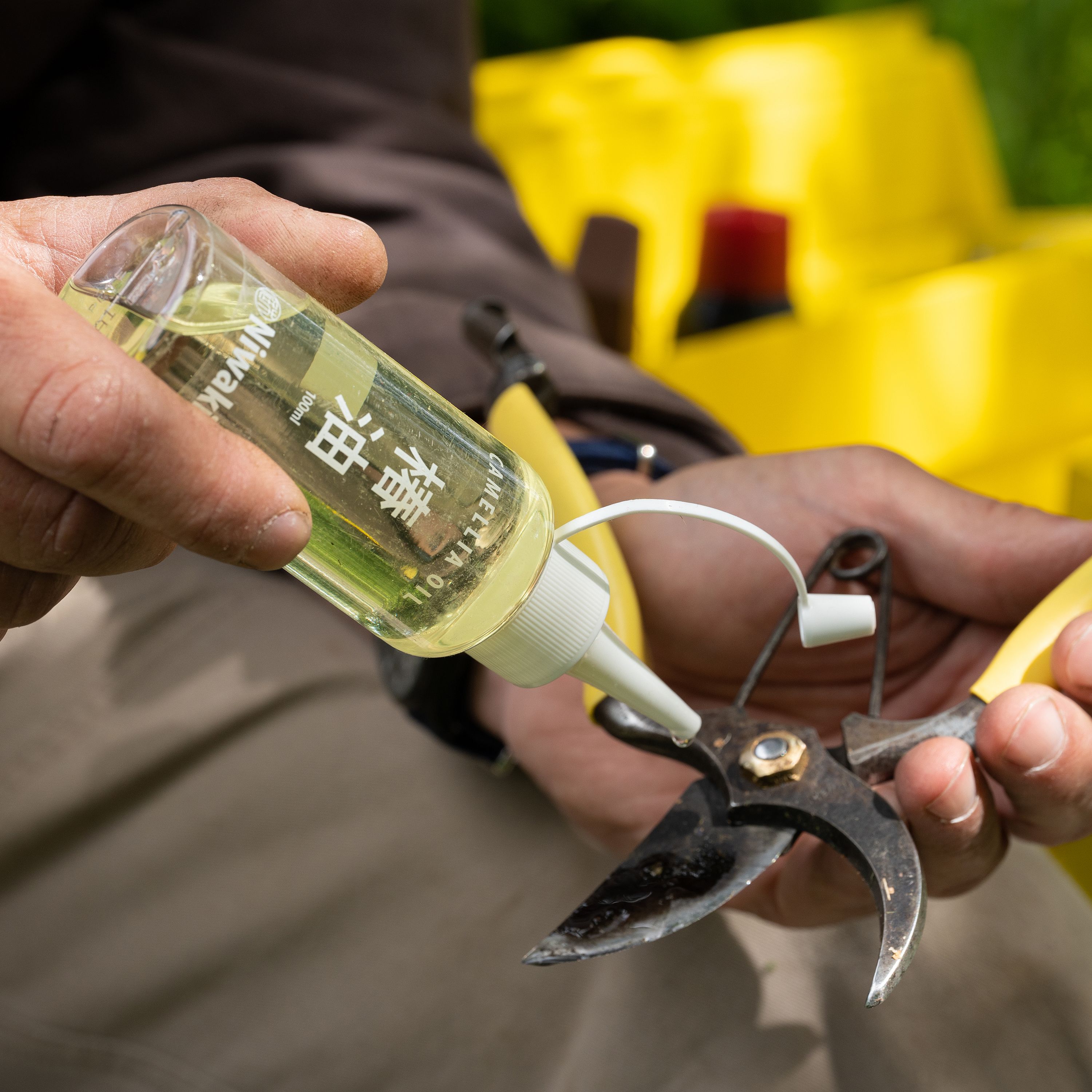

Your question has come up many times over the years and Camellia oil always seems to be the answer.
Personally, I wouldn’t worry about trying to prevent rust unless the knife is being stored unused for a long period. If this is the case then the long term storage answer is Renaissance wax. Don’t overthink it, just use them, it’s just a bit of sharp metal with a handle, it’s not going to dissolve.

I use the camellia oil shown on above with applicator (search in google and you will see what I mean) on my carbon kitchen and wood carving knives and it worked great so far.

If you buy an applicator the oil will last forever! So do not afraid of spending a couple of pound more on camellia oil.
