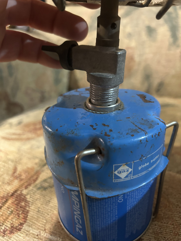

Collecting one tomorrow but when I mentioned it will need conversion for modern cartridges the chap said not needed and gave me link to The campingaz C206 GLS pierceable gas cartridge which seem common. Yet when I google the stove every one seems to mention conversions. Any one use one ?
I converted mine a few years ago. A simple job and well worth it, it makes the Globetrotter much more usable. I never liked keeping stove and cartridge together permanently, then the C206 became like hens teeth, so I stopped using it. There are afew YT videos on how to do the conversion.IMG_2004.JPG
I converted mine a few years ago. A simple job and well worth it, it makes the Globetrotter much more usable. I never liked keeping stove and cartridge together permanently, then the C206 became like hens teeth, so I stopped using it. There are afew YT videos on how to do the conversion.View attachment 99084
If you have converted it can you not use any of the modern cartridges that screw on or have I miss understood
Thank you for the info all guides so far suggest you pinch a valve off and old stove. When I google these old stoves though there about 30 or 40 quid. It’s going to cost me a tenner so will pick it up and do further research. Must be a five quid adapter some where :)
Looks like the internet was right the new carts don’t fit.
Will have to adapt it unless I am meant to push it to break seal then screw it

For me, it was just to keep an old stove that works well, going.
It also runs on a wider range of gas types. If I were ever to find a supply of C206 cartridges, it would be a simple job to convert back.IMG_2006.JPG
