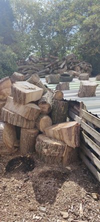

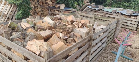

Our primary heat source for heating the cottage and cooking is wood
We cut split and stack a lot of wood... currently sitting at around 60 cubic metres. We've been doing this for a long time.
IMG_20220903_092639.jpgI have to echo the advice given. Cut it, split it, stack it off the ground so the air gets through and then cover it. It will burn much better next year and better still the year after. The only shortcut is a kiln to dry the wood. Otherwise its going to be useless this yearIMG_20220901_123908.jpg

Any loose waterproof cover for 24/7 will allow good ventilation for drying. Wood carvers estimate that wood dries 1" thickness per year (outdoors under cover and not cooked in a shed.)
You have a tall problem trying to dry your wood. Never close it in.
View attachment 77093I have to echo the advice given. Cut it, split it, stack it off the ground so the air gets through and then cover it. It will burn much better next year and better still the year after. The only shortcut is a kiln to dry the wood. Otherwise its going to be useless this yearView attachment 77094

Great set up for the cozy fireplace. Very classy too.
And tonnes of firewoods well equipped supply. Impressive. Thanks for sharing the lovely photos.
