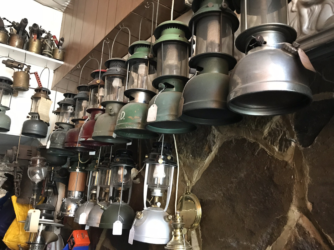

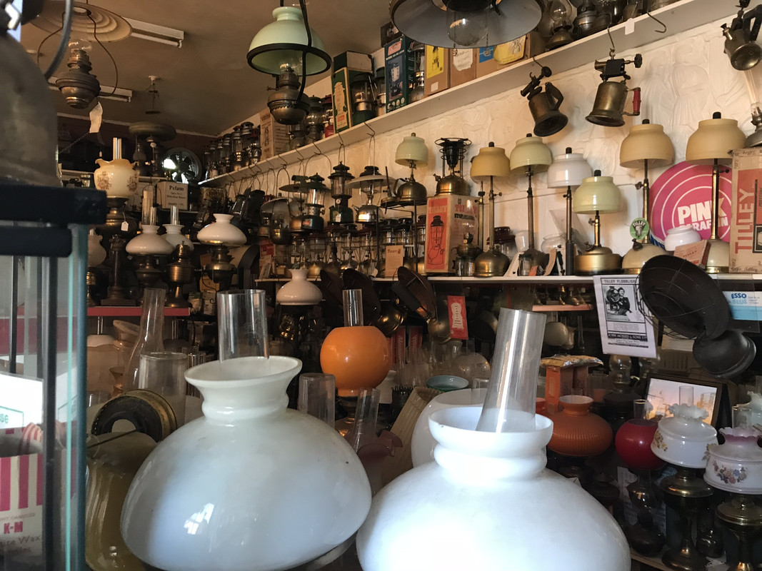

According to a mega stove enthusiast I met he doesn’t use panel wipe in anything, reckons it burns hotter and causes damage over time. He uses Aspen Blue. It’s about £20 for 5ltrs and is identical to Coleman Fuel.
Here is a pic of his shop, he knows his stuff.

Yep, the 4 stroke version, comes in a blue can. I don’t know enough about Aspen to know if there’s a 4 and a 4t though.
The guy in Littlehampton is old school, a serious lover of anything stove and lamp. He even has a couple of clothes irons that run petrol!
http://www.base-camp.co.uk/
While I was there he warned me off panel wipe for long term use, and also showed me why an ancient Vapalux needed a new vaporiser because it had always used Tilley mantles, causing the lamp to run a bit hot and damaging it over time.
