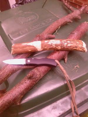

I see a bit of wood lying about and use it, like this
bit of whittling...and I ain't the brightest star in the nursery :rolleyes: produced this, cuts great and the handle is fine without all that stabilising stuff.
Nothing to write home about but does the job and dead comfy in the hand. :)
