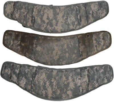

Would some LW tubular polyester sleeving help?
Just enough to make a couple of wings for left and right sides
It's 78mm wide and takes a bit of foam cut to about 60mm /70mm wide
I have a few metres left and would be happy to post you some. I should fit into a standard business envelope at letter rate.
You just have to find some old Karrimat to fill it with
